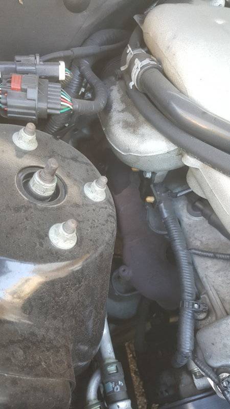

1) Leak below intake manifold that puddles (on lower manifold?) when not in use, and then burns off. I thought this was oil before, but given the coolant issues I'm thinking maybe it's just more coolant. I'll try to attach pictures of this one.

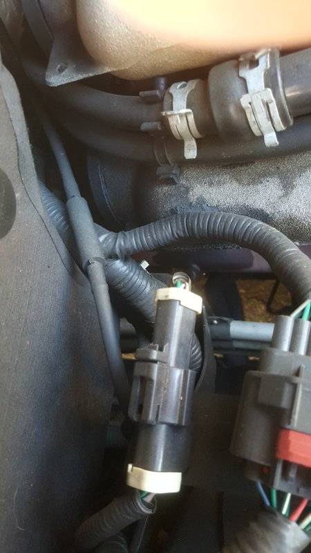

3) Recently an occasional small straight line of coolant can be seen below the driver's side firewall. About 8 inches long, seems to be directly below the degas bottle. Not sure if this is from the bottle itself or a hose, etc.

IMT gaskets. It drips oil onto exhaust manifold. Cheap fix but I believe you have to take off the cowl and strut brace. Might be valve cover gasket as well. There are 2 screws on the black round plastic piece that hold it in to the intake manifold.
99% degas bottle is shot. Its like 150 new and you can only use Motorcraft.
Awesome, thanks! That's just the sort of cheap repair I'm still willing to do on this car. Once I get the cowl and brace off, I will be pretty tempted to get to work on the cooling system. Looks like this $5 repair will turn into $500.
