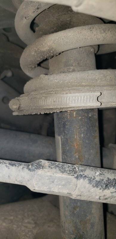

            Hi Steve, your rear suspension is none adjustable except for shimming the rear springs. Once you get the rear body height set to right height, the alignment should be within the acceptable range. When you go through this get a lifetime alignment contract costing 2x the single service to help dial the adjustment after each shim evenly added. Find the best lowest friction grease to needle attachment to apply within the boots with a dab of silicone to seal if desire. My rear suspension is over 200k miles old and still tight. The springs are Swift stock reproductions that needed about a shaft inch shim of plastic sheet cut out by hole saws. The shocks are Sach F&R with off road shock boots semisealed for oil lubrication. I hope get the car back to the original ride for the Advance Trak to be optimum. Steve

            can you explain a little more shims go how on springs,i have to put shims on top of strut or or take top off and shim im all confused

            Magnolia
            Hi Steve, the shims are at the bottom of the spring in the photo with a large hose clamp for strengthen the 1/2" thick Delrin shim. This worked to get alignment right and help the Firestone and Sears to fine tune the adjustments. Remove all top shims before you do this. Check the front control arm front bushing is not broken by applying a long bar to move the arm to indicate the break in the rubber bushing. It it is broken the front end will jump #feet opposite to your turn in a corner. If you have any more questions let me know. Steve

            As far as the shims that were mentioned... they are used to compensate for spring sag.
            They are roughly 2-3 dollars apiece through any authorized Jag dealer that can be found online. For the LS... they fit the rear only... and sit under the lower plastic isolator. No clamps necessary.
            And no shims on top. Only the bearing plate and top rubber isolator that helps keep the spring captive on the shock.
