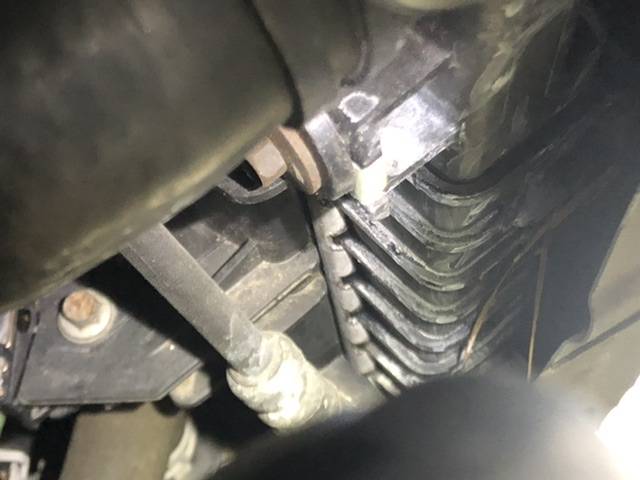

This morning, went out and popp'd the hood, looked and found a tiny leak on the passenger side top of the radiator...I'm like, "Really"..."Girl, I like you a lot but this has got to stop."

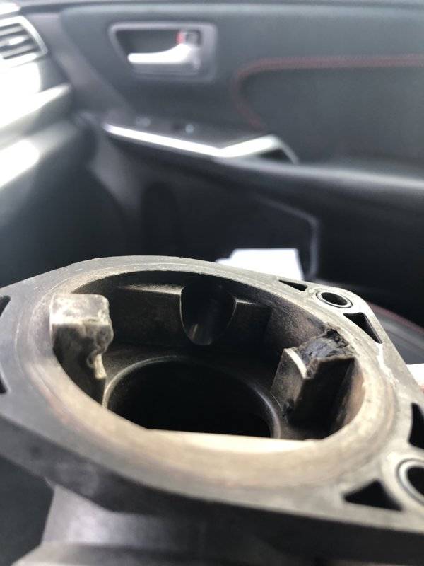

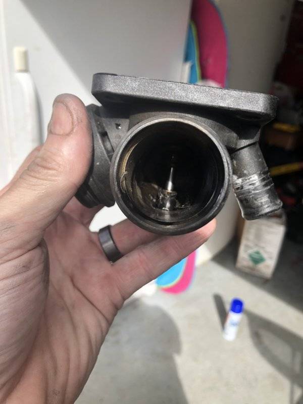

Here’s what I found... From what I’ve read here, that is a pretty common place for the radiator to be leaking.
Tackling the radiator today and went to change the thermostat cuzz it’s very important and not expensive and.... I replaced it and the entire plastic housing and plastic hoses a couple years ago, Fomoco parts from Tasca and this is the crap I find!!!!
Oh ya, I’m pissed at these cheap ass plastic BS parts that cost way more than they’re worth.
View attachment 828573801 View attachment 828573800 Tackling the radiator today and went to change the thermostat cuzz it’s very important and not expensive and.... I replaced it and the entire plastic housing and plastic hoses a couple years ago, Fomoco parts from Tasca and this is the crap I find!!!!
