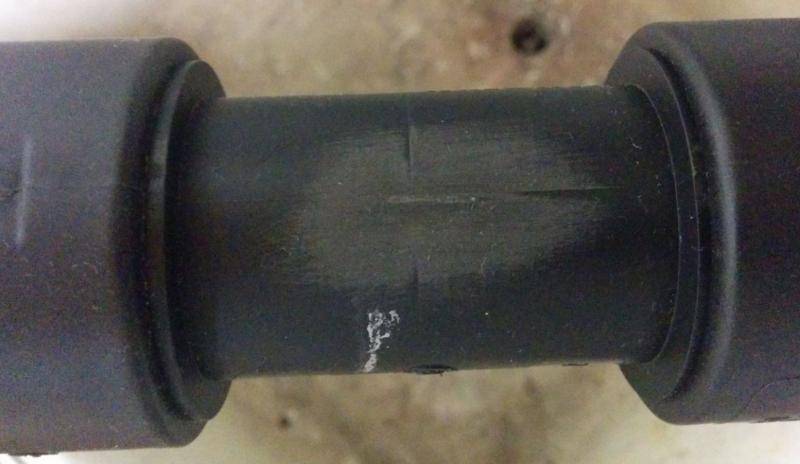

Did a search and noticed someone had one fabricated but other than that, are there any suitable aftermarket alternatives to the V8 upper rad hose (the KM-5356)?
I've got a 2005 and the OE hose leaked at the seam that runs lengthwise on the plastic interconnect piece. I replaced with a new OEM and it leaked at exactly the same spot within a couple of days.
Here's a pic of the original hose and the seam (lightly sanded) where it and its replacement leaks from.
Any suggestions? I have access locally to the Dayco replacement. Has anyone tried it/is it manufactured any better?
Thanks in advance.
A new OEM (Ford part number is 3W4Z-8260-BC) hose worked just fine for me. This was years ago and my original had a leak in the same location that you show. Note that all your plastic parts need to be replaced if you haven't already done so (they all fail at close to the same time).

And mine on my 04 leaked in that same spot as well. It's a weak spot and clearly a design flaw.
Well, the probably leaked as soon as it was under enough pressure but I didn't notice for a couple of days (didn't drive it much). I'm going to try another OEM one but hell yeah, it's a design flaw. I put some high-temp epoxy on it and I've been driving with it for the past few months, but it started leaking again so I figured I'd replace it while it's not the middle of winter.
Leaks like that would have to be repaired from the inside, patching on the outside, the outwards pressure just makes it mute. People try to fix basment leaks from the inside by applying gunk on the bricks and it's useless. Hydrostatic negative pressure but you knew that already I'm sure.

Just to give an update -- I picked up another OEM hose and it's been a few weeks and no leaks. I guess the first one was a dud.

As far as the part mentioned... all of the plactic parts are injection molded. I suspect he spot where this part fails is where the plastic is injected into the die,,, leaving slightly thinner material as the plastic cools.
