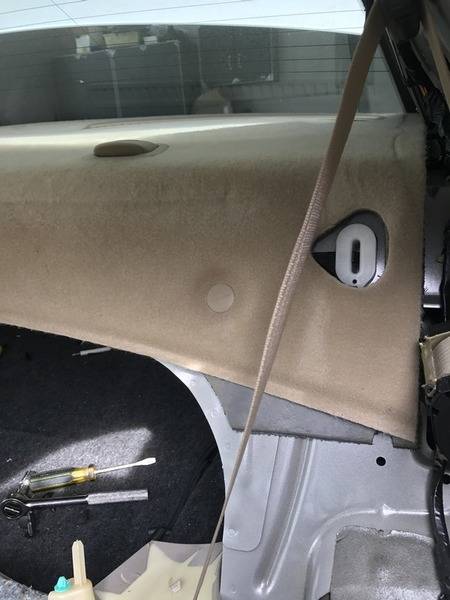

Now the fun part, getting those little push in style plastic fasteners out of the cover behind the bolsters.

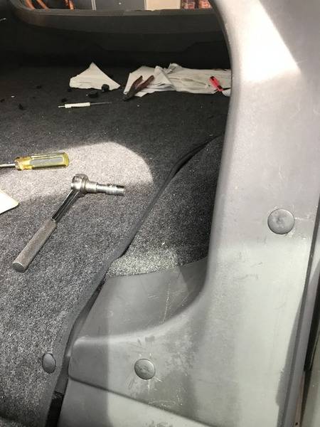

Next up is to remove the C-Pillar covers...I had a rough time with mine. The center push in pin with the long guide insert was really on there good, but with a little prying I was able to get it out of there.

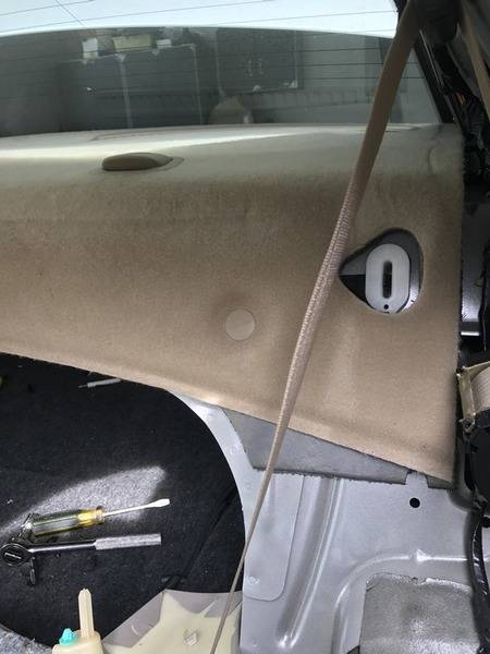

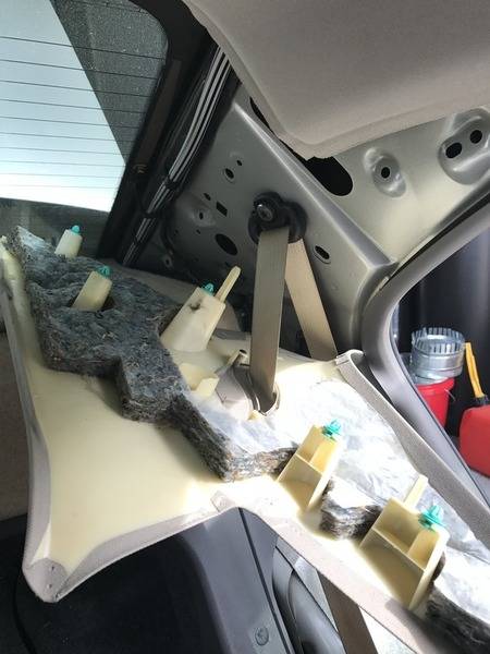

Now the deck lid...
There are only 3 push in style plastic fasteners, pull em out and wiggle the deck lid loose, going at it from any way you can...it's been in there for a long time and it's a tight fit...

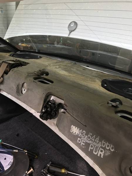

Once its out... all that work to get at the prize.
Remove them speakers!!! A 6mm socket will do the trick to remove each speaker's fasteners.

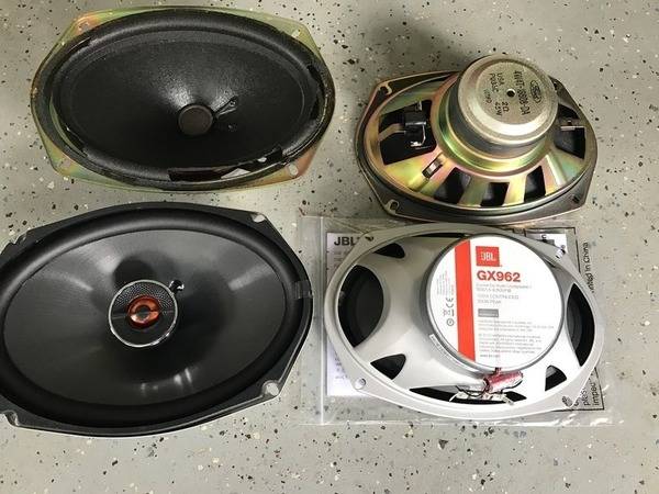

Here's a side by side of the old speakers and the new speakers.
I got these new ones off of newegg for $89...They are 2.3 ohms and they are two way speakers. As you can see, my old ones were pretty thashed.
