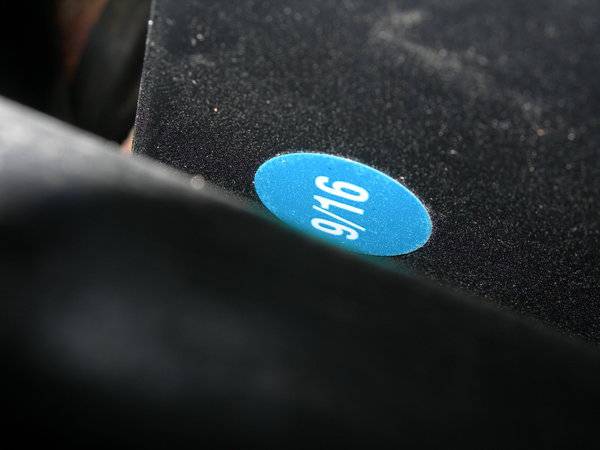

You havn't said how old the battery is in your LS. Look for a round sticker on the side or back of the battery. It will be a "date code" for when the battery was made.
It will look something like this:
