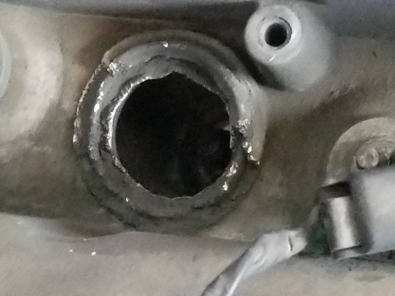

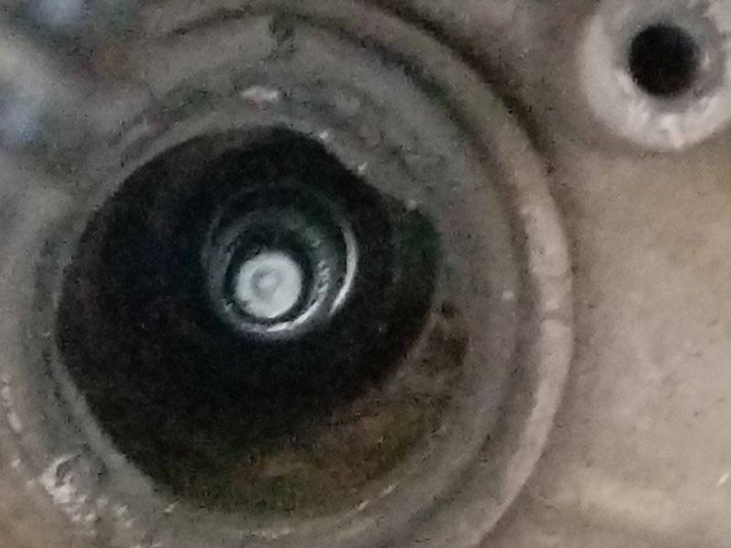

Started removing Coil Packs and noticed 1/2 of the grommet/seal has disintegrated. Has anyone experienced this and what is the remedy. No parts are listed at Ford. Thank you for your time.
----------They're COPs (Coil-On-Plug), not coil packs.
Yes, lots of us have had that problem. The seals come with the valve cover gaskets.
One source: www.amazon.com/gp/product/B0033DPMZE/ref=oh_aui_search_detailpage?ie=UTF8&psc=1
I am assuming you have the V8, since you don't say.
Sorry, it is a v6 3.0. If they'd fit v8 I'll buy them
