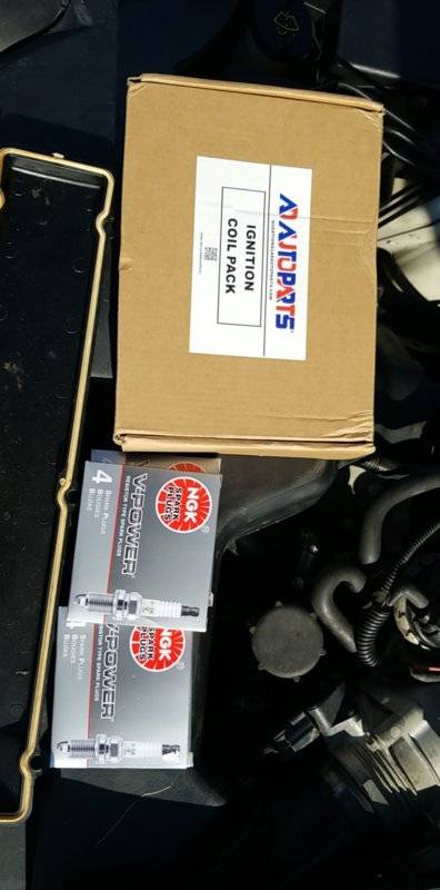

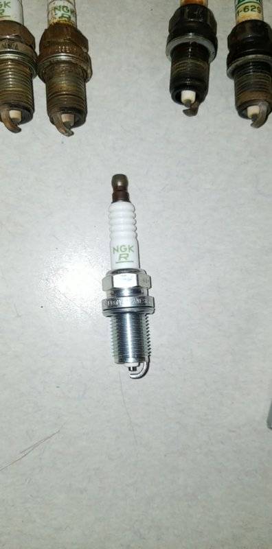

    LS put itself into etc failsafe mode did some research hopefully its the coils ordered some cheap ones to jist do the job waiting to get motorcraft due to bills were due and I'll have more money to play with later.
    Should I replace the spark plugs as well bought some to go with the coils but didn't know if it was required or smart to do?

    Location:
    Gulfport
    The cheap coils may put it into failsafe as well. As a bonus, they could also damage the PCM. It happens. Yes, you really should replace the spark plugs at exactly the same time. Bad coils damage plugs, damaged plugs kill coils, repeat.
    Cheap coils = bad plan, IMHO.

    The PCM can be damaged by ESD/voltage-spikes generated by bad or marginal coils. It damages FETs in the PCM.
    ETC failsafe can be (and usually is) caused by EMI noise generated by bad/marginal coils. If they are very noisy, it will happen very frequently. If less nosy, it will be only every now and then and can depend on how hard you are pushing the engine.

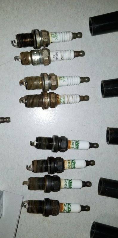

    Put on my new Spark Plugs and Coils yesterday MPG went from 16.5 to 25 and its a v8. Didn't get motorcraft so gonna see how long that lasts

    NGK was the factory plug for many LSes.
