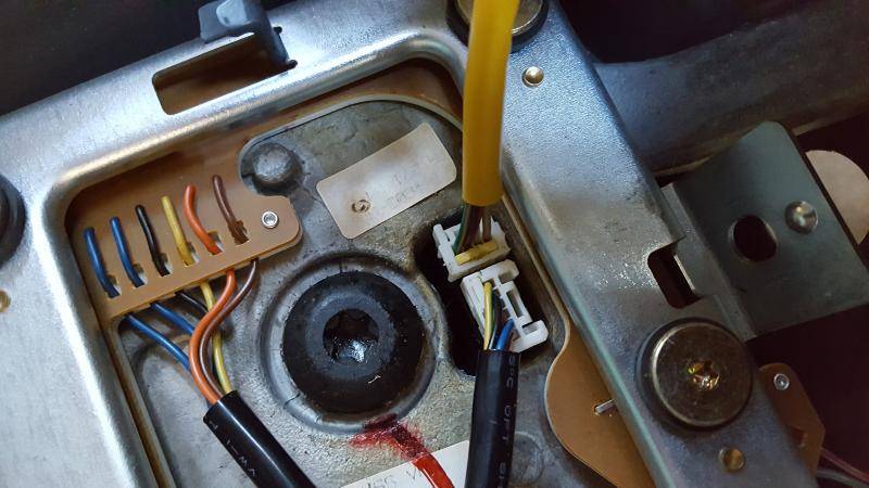

Trying to replace my turn signal switch on my '05 and I cannot get the airbag plug to release. I see the yellow piece in the plug going into the steering wheel assembly. But I cannot get the plug to release and I really don't want to break anything. What is the trick to get it to release?

Push down on the top (in the picture) of the plug. That will release a little tang that holds in the plug.

Thanks LS4me. Popped right out. I just didn't want to break it.
