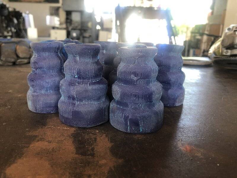

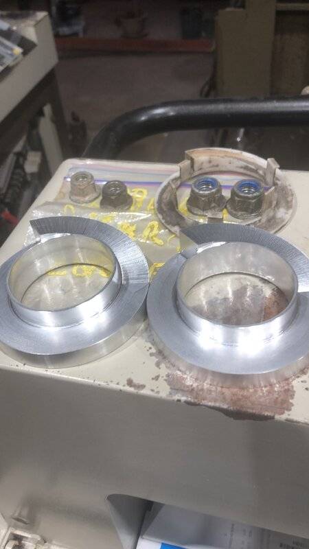

I had these parts made knowing the difficulty location oem shock hardware. The bumpers are Energy Suspension 2" dia 24" rounds machined as the oem and same for the spring perch of 6061 aluminum.

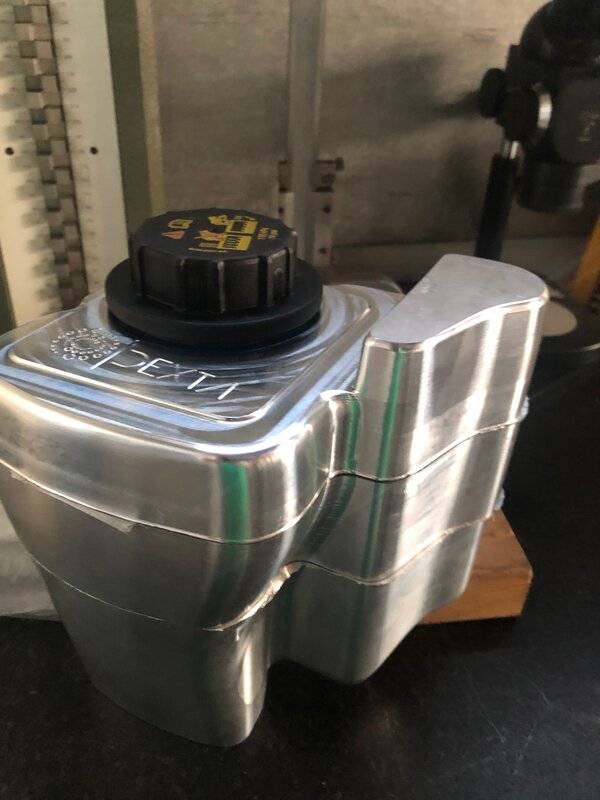

I found the machinist to make those spring perches, all of plastic cooling replacements including the degas tank to aluminum, oil filter bypass block and many other parts i couldn't find anywhere. I found Swift Springs USA to make an exact coils f+r copies of what i sent, 800/set. Read up on the Swift steel. The most comfortable ride with or feel of the road with the top shocks having a Nanolub oil bath for shaft/seal lubrication. I also found Ron Davis to make me a custom 2 two core radiator, top quality unit. You might want to send a old one for example. A little investigating can yeild some pretty talented people to create better parts for these LS's and also repairing them.

A talented machinist can do about anything... especially when they have a part to work off of to duplicate.
You may want to consider having some urethane pieces made for the spring seats. Otherwise you may have some NVH from the metal to metal contact between the spring and seat.

Swift Springs made me a set from the oem front and rear examples I sent. The only problem getting the car aligned was the rears were 1/2" short. I had 1/2" delrin sheet the shims were made from and the old car was arrow straight again. ( 04 V8 Sport )

I'll talk to the guys that made the springs at Swift and spring perch & cooling system parts. The Swift rear spring made was about an half an inch short as the old example was for proper rear height to get the car to align right i shim an half an inch.
I had powder coating ( any color ) on most front engine brackets and anodizing cooling sys part, whole radiator ( black only ) reasonably done too. FYI
