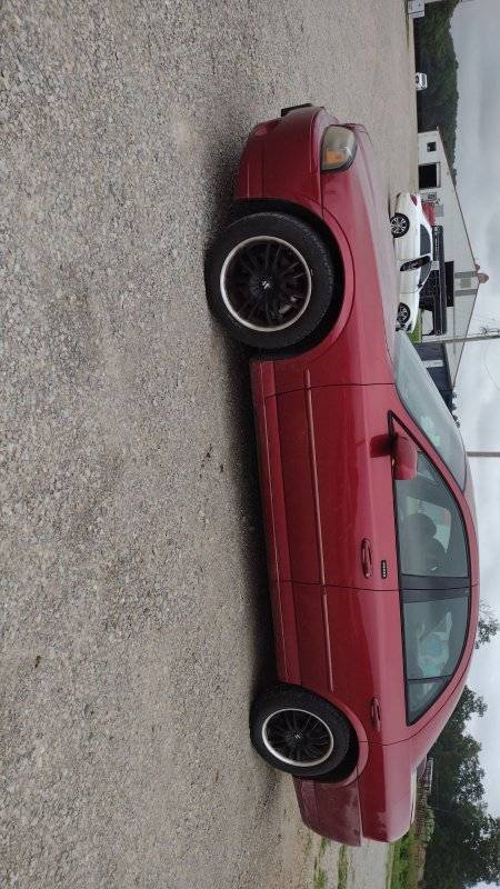

I bought a 2004 Lincoln lse over a month ago and recently started problems with my car showing ETC Failsafe and goes into limp mode. The first night I parked it turned it off and back on and then it was fine, it's happened 3 times and I do the same thing every time as it's always when I'm driving to or from work as I rarely go anywhere. I plan on replacing the coils and plugs and maybe the electronic throttle sensor as I read something about that. I also have been trying to fix the my sunroof leaks as it runs down my front door frames, and my ac is cold but doesn't really have a strong output any recommendations? Other than that she's a great car with lowish miles
