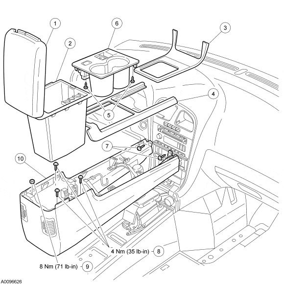

How do you pull the shifter surround on a Gen II?

It's item 3 below. I don't see how you can miss it.
Flip open the door over the ash tray and pull/pry the ear of the plastic piece in question at each side. You'll have to bend it back fairly far on each side to release it.
You can pull it up first from the back (between the shifter and the cup holder section) if you prefer, but it seems like it is less stress on the part to pull it from around the ash tray first.
