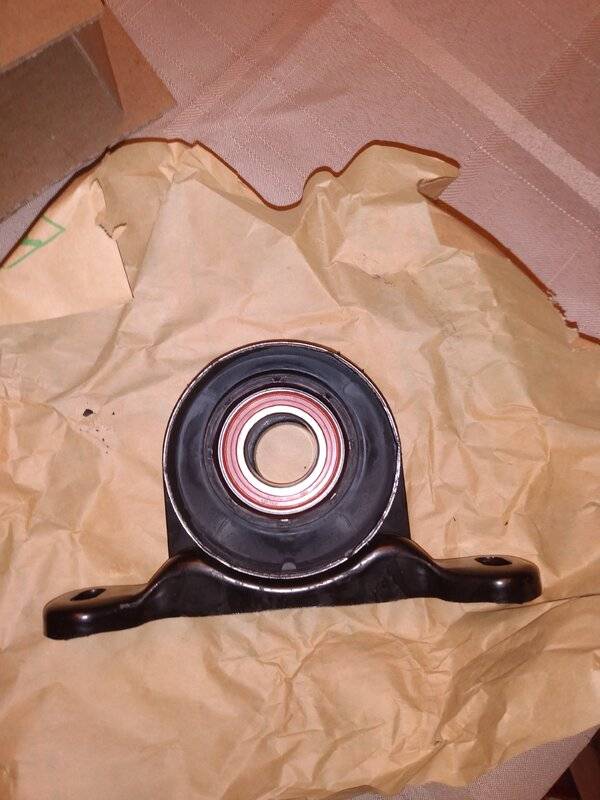

Here's a pic of the part, and part number.

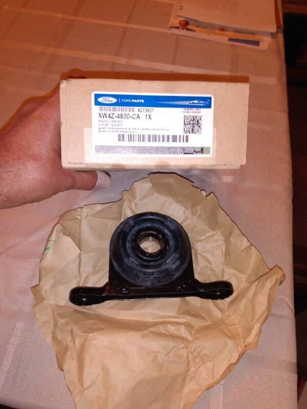

And a pic of the other side of the part.
I would not drive it anymore... until you get the bearing replaced... or you may do much worse damage.
