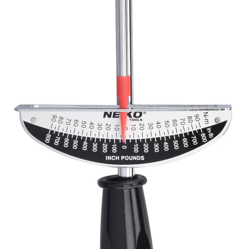

The torque needed is in in-lbs, not ft-lbs. The wrench I have for this is 1/4" drive. Hell, my wheels only require a 3/8" torque wrench to get 100ft-lbs. There is also a sequence that you should follow to tighten it

star date : learn from experience ….old style 3/8 torq wrench with the little bar flexer had nm and inch lbs I got most of the cover and similar jobs with it just slow going but works no leaks I know its working because I was just there again through the plug tube cap all nice and dry in tubes
