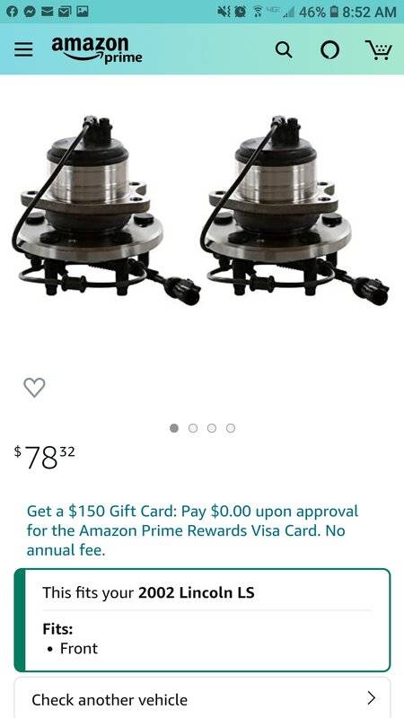

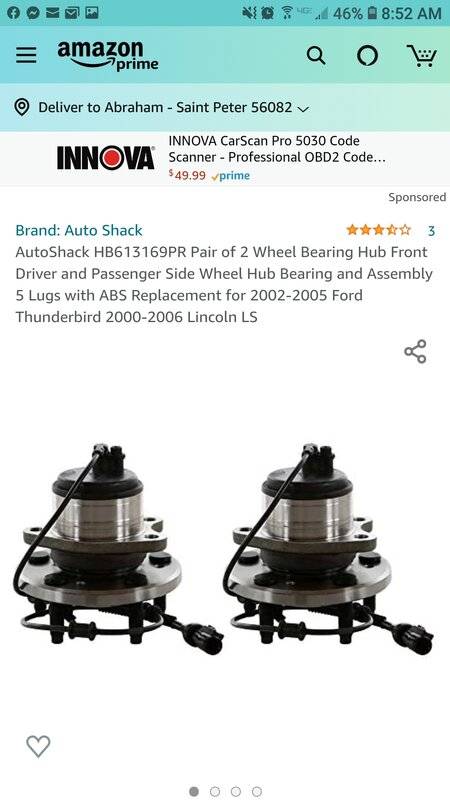

Just replace the entire hub assembly...the fix is easy and hub assemblies are cheap $$$$$ you may want to spray the hell out of the bolts a few days prior to changing it out with pb blaster or buy a torch ..depending where you live if winter salt plagues your car ...RockAuto or Ebay or Amazon all sell many brands that are good...

That sounds like the plan. Thanks for the links!
I bought those exact ones and had to replace them twice because the abs sensors they use are junk, they made the abs light come on, traction control quit working and my interior lights wouldnt work, i finally used the factory abs sensor on the new hubs to get them to work correctly
It was an example of what the average price is of an aftermarket...I have used these on 2 different LSes with no issues what so ever...the RULE OF LIFE you get what you pay for ...so if someone wants to go with MotorCraft over aftermarket that is a personal choice...I'm driving a almost 20 year old car 2002 Lincoln LSE and I try to save $$$ when I can but there is some parts that I stay with OEM or Jaguar S-Type parts ...this has never been one ...I guess I will consider myself lucky
