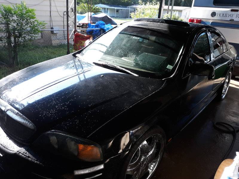

Hey I have a 2002 Lincoln LS 3.9 L V8 sometimes start and sometimes wont start. The no start problem is more frequent now. I installed a brand new starter two days ago on June 8th 2019 and I installed a brand new battery with higher cranking amperage. Battery cables are okay, battery terminals are brand new. Aternator was put in 3years ago and is still charging fine when the car is running and according to the owners manual the function of the car alarm system is normal. After I turn the key to the start position, all everything on the dash goes completely off and the starter wont turn over at all. There is absolutely no sound at all. No clicking sound, nothing. The vehicle has full power when this is happening and headlights dont dim when turning the key. I'm tired of spending money somebody please help!
