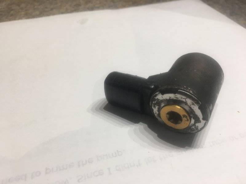

The first pic is where the t40 went to remove

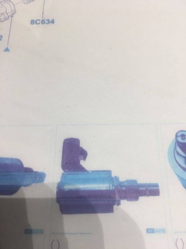

The second pic is what is left of the actuator off the pump and it shows where it screwed onto the part that is left in the pump.

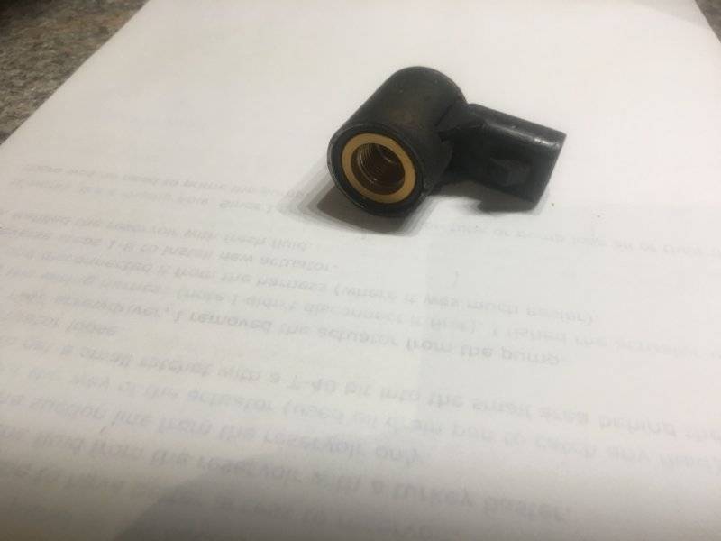

The third pic is a pic of a new actuator

Yeah, that's not the whole actuator that you have removed, just the coil. The valve part must still be on the pump.
Is there a good way to take it out that you are aware of?
I haven't had to do it, so I can only go by what I have seen posted here.
Besides the one who filed a slot into it, I think that someone else hammered a socket over it.
I wish I knew how far the threads on it go into the pump and if they don’t go in any further , what the heck holds the rest inside ?
