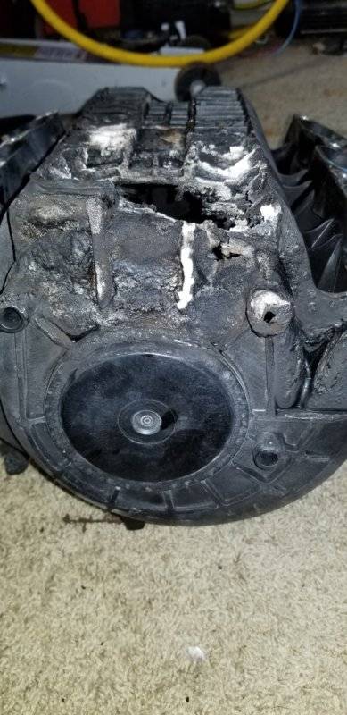

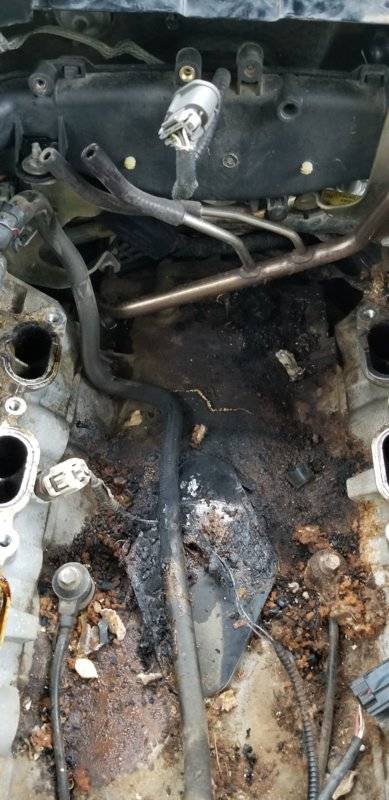

        I think I found the intake leak...
      • joegr
        joegr Dedicated LVC Member
        Messages:
        20,140
        Likes Received:
        1,548
        Joined:
        Dec 10, 2005
        Location:
        Gulfport
        Wow!

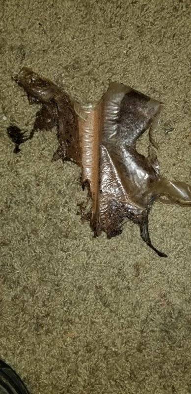

        It's pretty amazing it ran at all. My best guess is a mouse chewed the CHT sensor wire and they shorted and created a fire. The first pic is the remnants of some sort of insulation or heat shield. Will I need to find a replacment for that? Is it even available? 20190503_200332.jpg 20190503_185230.jpg
      • joegr
        Messages:
        20,140
        Likes Received:
        1,548
        Joined:
        Dec 10, 2005
        Location:
        Gulfport
        I don't know how critical it is, and if it helps with the knock sensors or not. I don't know of any sources other than junkyards.
