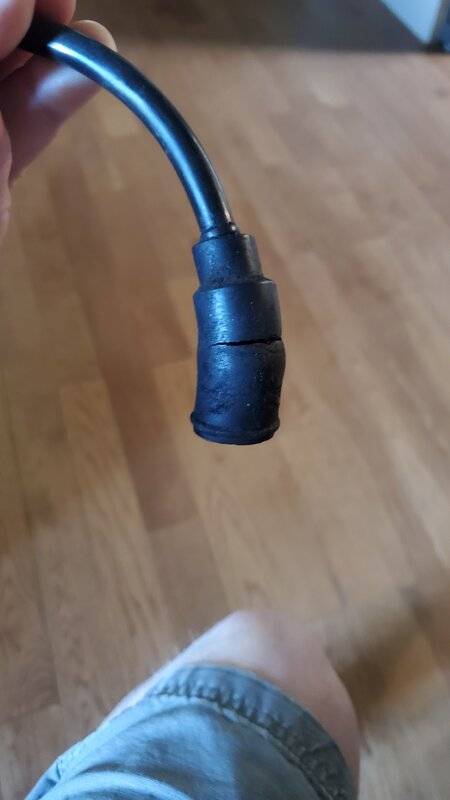

milehighmikey
Apr 2, 2007
824
64
Nashua
Check the hose that connects to the PCV tubing at the end of the intake where the hose transitions from about 14mm in steel to a 14mm rubber transition to 8mm for the plastic tube that runs to the throttle body, where it turns it back to 14mm by using that same adapter at the other end of the hose. Mine was cracked in a stealth way right in the middle of that 14 to 8 mm rubber fitting. Unfortunately, you may not be able to see it with the cowling and brace installed.
