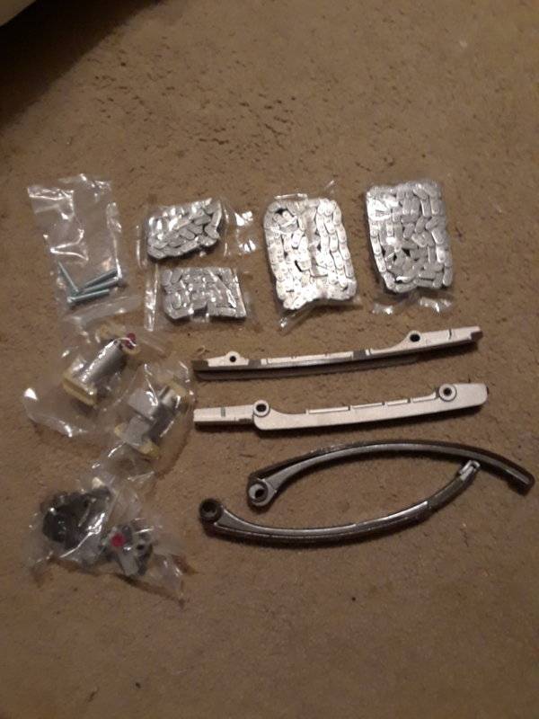

Here's some pics of the timing chain kit I bought online from a place called Prime Choice and they sell parts through eBay as well as their own site. They prices are unbelievable and always great feedback. Mine shipped in 4 days free shipping $50 No tax. No fine print. no misleading ad description. Everything is there that is supposed to be. I'm really impressed. But plz tell me if this is what I need as far as you can tell. Besides the two tools I'll need from Amazon which I'm gonna wait on this feedback before spending the money. Hopefully you guys are unable to convince me tok change it all because I'm strongly considering changing just the passenger side tensioner.

So, yes you do have the 1st generation system - not the corrected 1st gen. BTW the corrected 1st gen is basically the same as the rest of the production in 2nd gen, thus why 2002 didn't have as many issues. Now if you kit includes all those parts, you are good to go, short of the fact that the kit does not include the myriad of gaskets and seals that are also needed. Go to christophers foreign auto parts to see what I mean there.
IMPORTANT NOTE FOR ALL: that pic in the Amazon is actually WRONG. the long chains with the quad links is 2nd gen and post May 2001. The 'correct' chains for pre may 2001 is just like the bike chains pictured (shorter ones). Thus why they are weaker. Mind you, the pictures are not always accurate at Amazon and likely the kit would be shipped with bike chains. I used this pic so he could get a feel of all the parts that should be there and a more realistic price point.

yup, I did a little more search and appears that someone is dumping stock on these parts. LOTS on ebay. From your pic, it looks like you have the bike chain style there too. Not the quad 'over top' links 2nd gen. You just need the myriad of gaskets and you are set.
That's the one I got. It was only $50 at Prime Choice.
