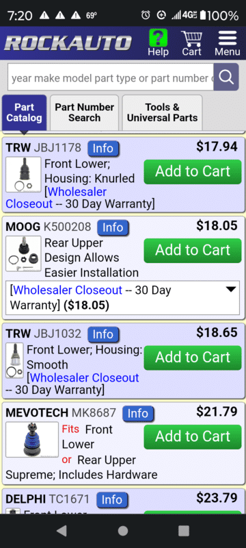

I know I can buy the ball joints, which I did. It looks like the replacement procedure is a black hole. I will do a DIY myself when I get to the job.
I thought I saw some arms on Rock Auto.
