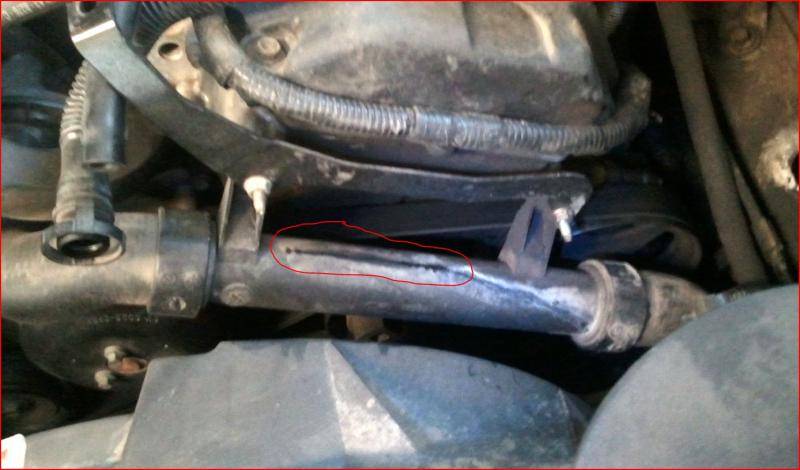

My lower radiator hose cracked (blew) yesterday while wife was driving. See circled portion of photo where the plastic portion cracked. Car overheated. Got it home after letting it cool down. I found out this lower radiator hose (without the oil cooler lines) is a special item and not even stocked locally due to the special plastic middle portion that's about 12 inches long.
Carquest stocks a lower radiator hose but it has the oil cooler lines to it. They said i could bypass them. My car doesn't have the oil cooler lines.

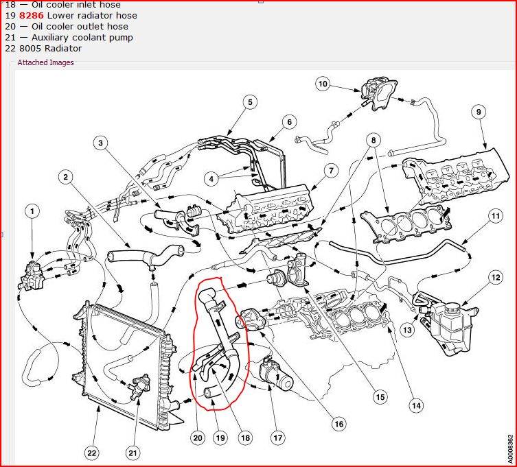

I think rock auto stocks that $47.79 it says without cooler lines im pretty sure thats the one you need.
You would be wise to replace the other plastic cooling system parts (including the upper radiator hose) at this time. My limited experience is that they all start to fail at close to the same time. Since your overheated, that may have added extra stress to the rest of the parts.
I don't know about gen I, but a full set for the gen II is about $500.

Joegr, Are you referring to the following parts in bold and from the diagram?
Manoli, Thank you for the rock auto info.
1 — Coolant control valve
2 8260 Upper radiator hose
3 8A520 Coolant outlet tube
4 18472 Heater inlet hoses (2 req)
5 18472 Heater outlet hose
6 18476 Heater core
7 6049 Cylinder head RH
8 — Cylinder head gasket (2 req)
9 6050 Cylinder head LH
10 — Throttle body adapter
11 — Engine vent hose
12 — Degas bottle
13 — Relief valve
14 6015 Cylinder block
15 8A587 Thermostat housing
16 8501 Water pump
17 6A642 Oil cooler
18 — Oil cooler inlet hose
19 8286 Lower radiator hose
20 — Oil cooler outlet hose
21 — Auxiliary coolant pump
22 8005 Radiator

In this latest case for my car it started overheating, I popped the hood saw coolant on top of the air cleaner. when I got it home to the garage I removed the air intake/air cleaner and saw the hard plastic tube section of the lower radiator hose had a hairline crack down the length of the tube (see red circled section of the hose in the 1st photo I posted).
Just a guess on my part, but if your coolant leak is coming from between your headlights look for a leak at the radiator itself, lower radiator hose, oil cooler hoses (if your car has these). A pressure test of the system should find the leak.
