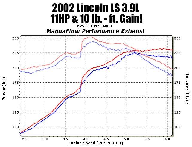

Here's magnaflow's gains dyno. A little confusing (at least to someone who has never run a dyno), but the blue lines are old performance, red is new. Bold is horsepower, faded is torque. The HP with the exhaust stays under 250, so it is most likely that the engine makes 252hp at the crank, especially since most manufacturers report power at the crank. Its simply a high number to report in an incomplete numbers game

Tune and changing the Gen 1 exhaust are about the only noticeable off the shelf changes. Gen 2 supposedly has much better exhaust flow
that usually means either a valve float issue, or a restricted maf, etc...
not sure what the squiggly lines like that mean on a ls dyno'd.

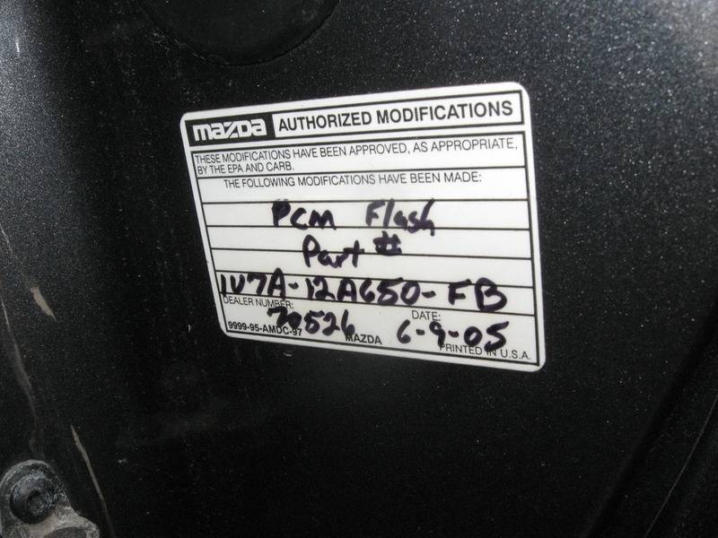

Also as far as tune I have no idea what it has right now since the sticker inside the door says it was last updated at a Mazda dealership and has some code I don't understand. Any one know who much or if Lincoln could make sure its on the most recent programing.

By tune I mean an outside tuner through an SCT unit, not just dealer reflashing.
The blue line, factory, it seems like it should be smoother if car is running correctly.
Looking at it and thinking about my experience with my 02 V8, I may have an explanation. Assuming they ran the dyno in 4th (1:1 engine:driveshaft speed), there's a thing it does at about 80mph at WOT in 4th where it feels like the torque converter locks up for 2 seconds, then releases and continues as normal. The RPMs drop (audibly with the aftermarket intake tube). I wonder if it's related. It's at about the same RPM.
