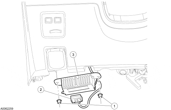

I never saw a factory amplifier like the one pictured in this ebay link. If my car has one of these, where would it be mounted?
Amplifier Lincoln LS Thunderbird 00 01 02 03 04 05 06 533069 | eBay
So, nothing at all on the rear deck, but you do have the CD changer?
If so, then you probably don't have the two small center console speakers either. The amp shown is the amplifier for those.
(driver's side under the dash)
It was only useful with the stock headunit with the DSP output for center channel.
