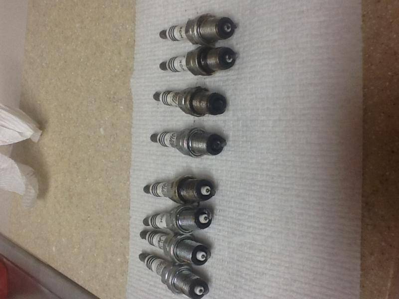

I think I might have lucked out and don't have valve damage. The knocking I was hearing hearing was my dumb self leaving a hose unhooked from that plastic piece that is at the back of the engine. And I also think the slight rough running might be fouled plugs on the drivers side from when the timing was off. I'll post a pics of the plugs, can they be cleaned instead of replacing. The only have a little run time very little,
Here are the plugs darker plugs are all out of the drivers side.
i would use a quick drying liquid...and a old tooth brush.
90% strength alcohol, brake or carburetor/injector cleaner or mineral spirits are good choices.

I might have, not sure. I don't think these spark plugs are cleanable. I tried carb cleaner and a tooth brush and they are stil black. It the white part in the middle ok to be black? Seems like the tiny metal part is what I should clean?
I've used a torch to clean fouled plugs in my toys, but just get new ones.
Installed four new plugs and gapped them. All plugs in everything plugged in and it still has a vibration when running. Starter seems to start the car right up now. I still need to figure this vibration out.
