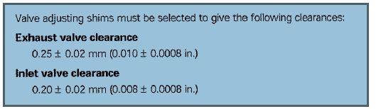

Where can I find shims are they removable or they are a bucket assembly? for these engine I looked everywhere but couldn't find any
Even looked for the whole bucket but no luck

first you need to check clearance with a feeler gauge and then buy the shims. there is a special tool to compress the valve springs so you can fish the shim out with a magnet. otherwise cams have to come out.
shims can be bought from jaguar
5w20 is not needed under any cold weather circumstances. fuel economy reasons only.
I do have a few valve spring compressors laying arround, will be checking clearance and then remove all the cams since I dont have the special tool.
I will tackle this job in a few days when the weather starts getting warmer
Do you have a link for those shims?
just wanted to make sure is the new shim size = (measured valve clearance – specified valve clearance) + old shim size
Thanks
correct. if the cam is out you can just fish the shim out with a magnet and you’re good to go.
