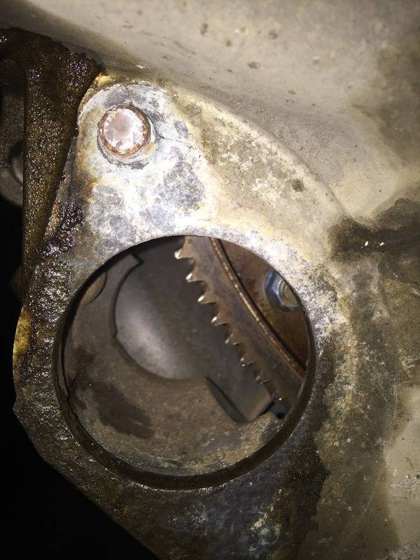

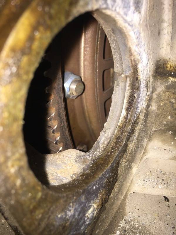

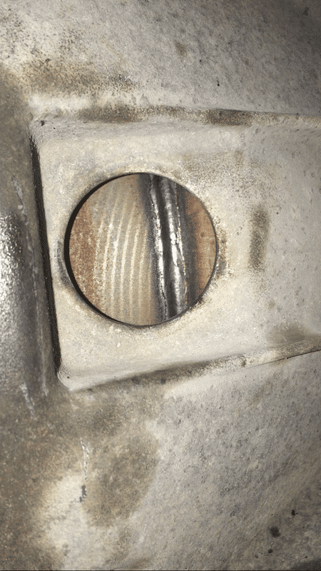

The rubber plug only lets you see the very bottom of the tc. No bolts. Here's s few pics.
Straight on the starter hole
From side of the hole. Also tried a swivel and socket not enough room
Under where the rubber plug was. I made a video and turned crank didn't show any bolts
V6 is different i guess. Just separate the trans from the engine block since it's out of the car. The input shaft will slide out of the torque convertor.
That's what I thought also. I took all bell housing bolts out and it wouldn't move. Maybe it's stuck on the guide pins.
The guide pins do get stuck. Steel sleeve in an aluminum hole. Try some heat or just beat them out with a hammer.
