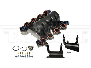

Congratulations! You should find out if the intake plenum has been replaced, if it hasn't you should have that done. There was a problem with the original one.
If you are interested I can get you an aftermarket bumper for 135 +shipping (if they are in stock) and an intake for 210 +shipping (oem) if you need to replace yours.
What was the issue with the plenum? Vacuum leak?
The OE composite intake manifold will fracture in the coolant crossover to the thermostat housing. Not a good experience.
The aftermarket and probably the FoMoCo current designs employ a metal crossover and stat housing as shown below.
Flat rate replacement time is 4.8 hours (severe case scenario).

Wayne, typically the failure doesn't have a beginning phase. When it lets loose it's a done deal and you are now a pedestrian.
In other words, it's a disaster just waiting for a time and place to happen.
Not replacing it, is like rolling the dice.

I was not aware of this issue. Is this common to all the 4.6L engines like the ones used in the grand marcs? I believe the motors are identical so I assume the same issue exists.
Did Ford correct the error? Did later models get a corrected intake and if so at what model year was it corrected so that I know what year intakes to look for if I do want to fix it?
Was there a recall over this issue? It seems to me if this is a common occourance, Ford owes us a new intake.

Did you not read the bulletin I posted?
http://www.lincolnvscadillac.com/showpost.php?p=2037266459&postcount=8
All your questions are answered within.
I don't believe there was a "recall" and it was a field fix only for those manifolds that failed. I think Ford's liability has run out, so good luck trying to get a new manifold for nothing. It's not going to happen.
Do you mean Grand Marquis? 96-01, just like the bulletin states.
