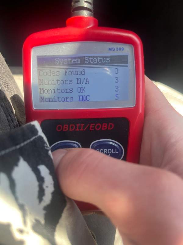

it didn’t give me any codes
Ok It's got fuel in the tank and doing the same thing with a charged up battery and now that it's not showing any codes my first thought would be to start checking things like @clubairth mentioned i would check my fuel filter to make sure its not stopped up. If you can easily blow air through it its not stopped up if its impossible to blow air through it then its stopped up replace it and try to start the car. If its not stopped up then while you have the fuel filter off lay a piece of cardboard down or maybe something to catch a small amount of fuel, have someone turn the key on and off just long enough to give the fuel pump enough time to prime up while you watch under the car and see if fuel comes out of the line where you took the filter off. It should put out a decent amount of fuel. If fuel comes out you'll know for sure the fuel pump its pumping fuel. Ive seen vehicles do some weird things before. So after you check the fuel filter an fuel pump and you know for sure its getting fuel up to the fuel filter i would check my catlytic convertor next to make sure its not clogged up to the point its choking the engine off and not allowing it to start. You can try taking the 02 sensor out and try to start it and if it cranks then you'll know you need to replace the convertor. If it cranks it'll run rough with the 02 sensor out but that'll let you know the cats stopped up. These are just a few things you can check yourself that doesn't cost you any money. Hopefully you'll get lucky and the problem will show itself when you do these things. When you get done come back and post what happens, what didn't happen and then we will go further to try to help solve you're problem.Good Luck!
