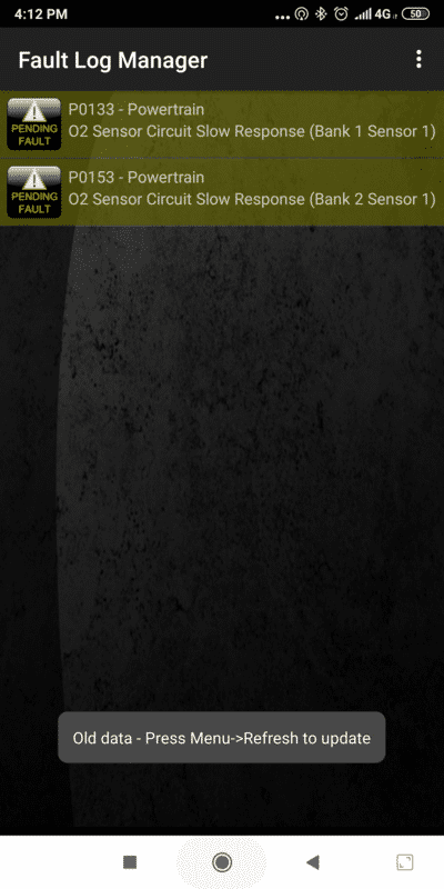

So I noticed by my exhaust sound what sounds like small misfire, but subtle. Scanned and got slow circuit response. So I'm assuming ignition coils.
I just did them 7 months ago. But I did not do the Sparks. So do them both?

Last time I posted, JoeGR mentioned it might be my cats sensor. I think he's right.

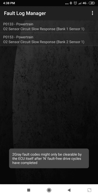

I punched it a few times on the hiway back, I smelled carbon, and then scanned. The codes greyed out (ECU was clearing). Then when I got off the hiway, and gave it a few more redlines, codes went away. Engine hums smooth.
(It wasn't really a noticeable misfire before, like, it was ever so slightly, and I detected it because of the loud exhaust. But it could be in my head.)
I seafoamed it last time (using the compressed can, not liquid) and CEL went away for a bit. Then came back. So I did ignition coils. CEL Went away for 4 months. Came back in spring, I punched it, and CEL goes away.
So I'm suspecting either I have clogged cats, bad O2 sensors, or Carbon build up. Or a combination of the above.
