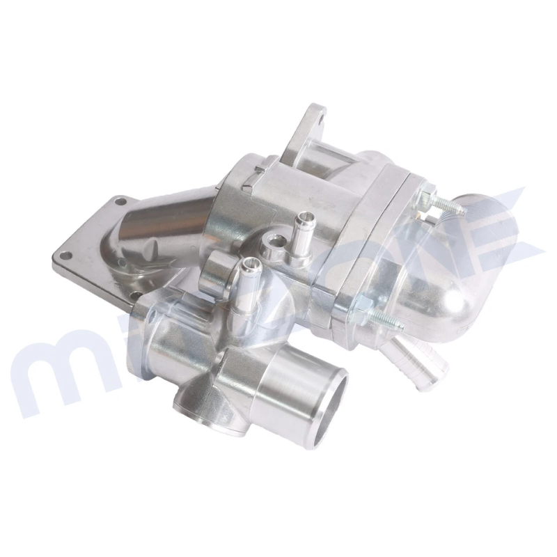

The Gen 2 cooling system parts are now available in aluminum - the critical parts at least. I installed them a couple of weeks ago. Search ebay for Jaguar cooling parts "Mitzone". I thought the parts seemed surprisingly good considering the cheap price.
