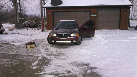

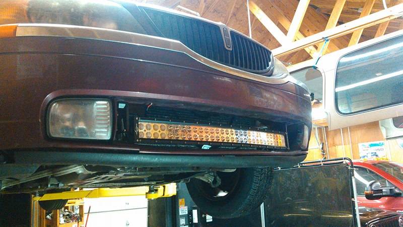

Added a light bar and tied it into the high beams with a relay. Wonder if you can do the same with the low beams.
