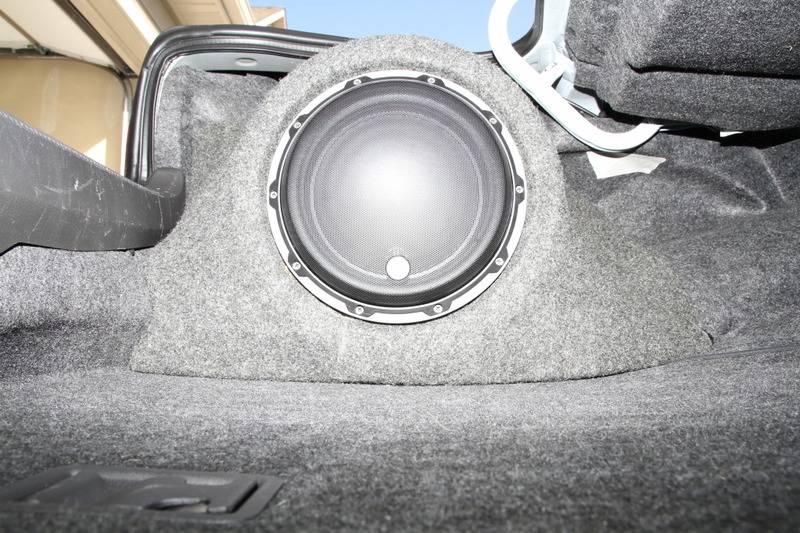

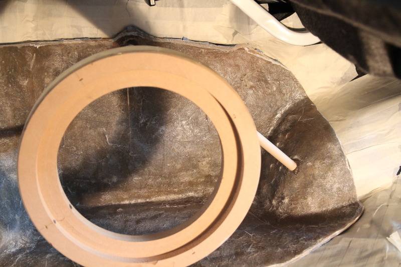

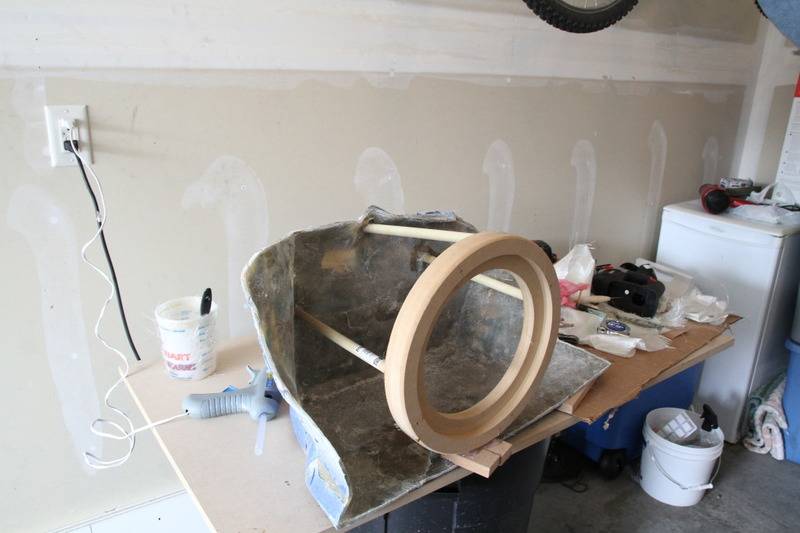

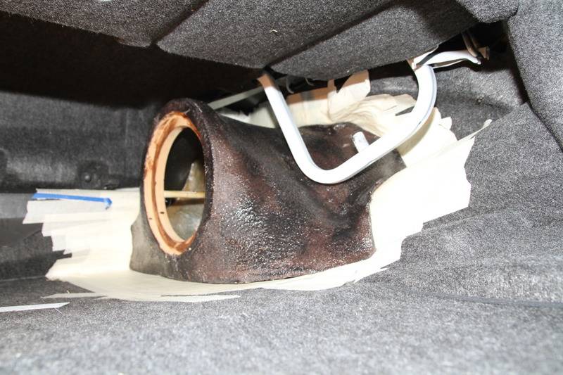

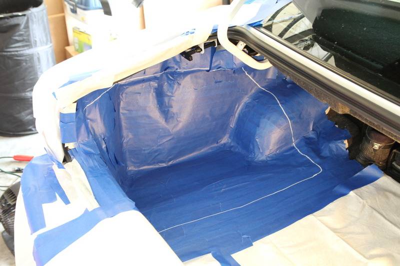

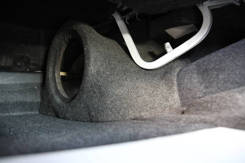

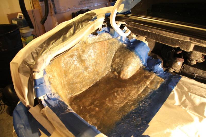

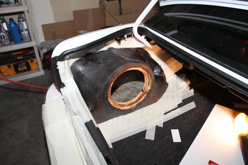

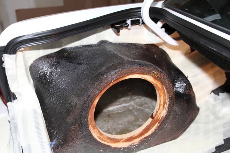

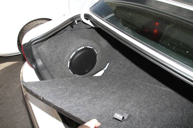

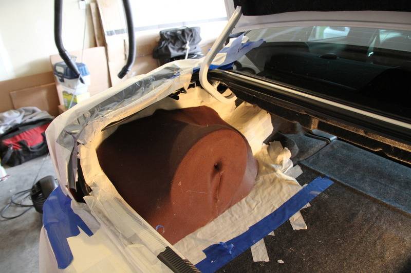

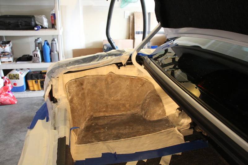

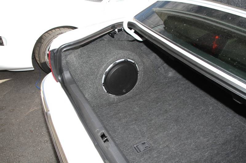

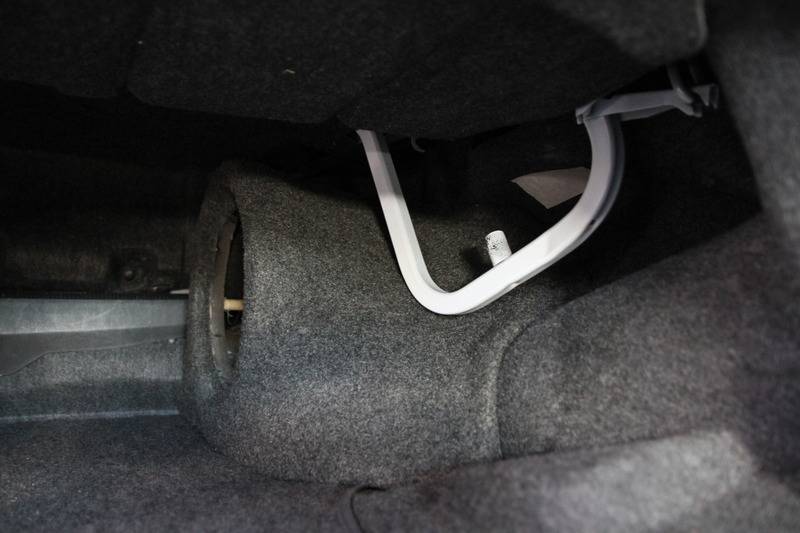

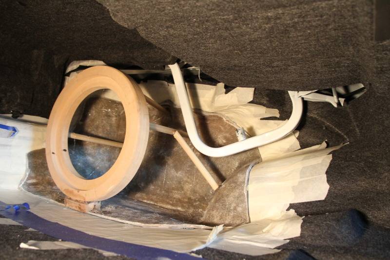

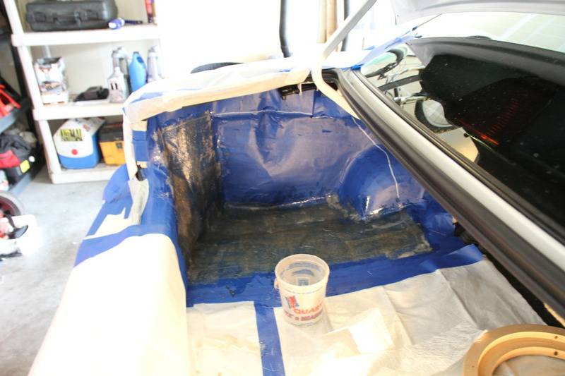

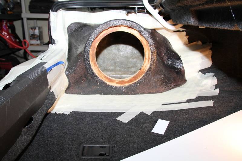

Then I got to work building a custom sub box.. I needed bass, but this is my DD, and I travel, so I need my trunkspace.. A regular box wasn't going to work. I've done fiberglass before, but never a negative mould.
This was my first.. and it turned out great..
The battery and fuses are under neath the trunk floor, so I made the box so the trunk floor could easily be removed, while the box remains in place..

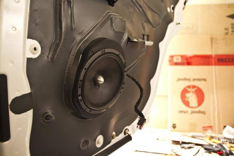

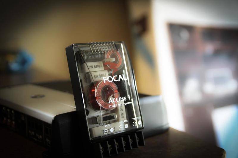

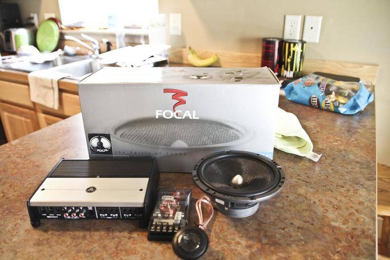

Then I ordered some Focal Components and 4 Channel Amp. The Cobra has a RIDICULOUS SQ stereo system, but this one gives it a run for it's money with about 1/4 the power..
Beautiful Crossovers..

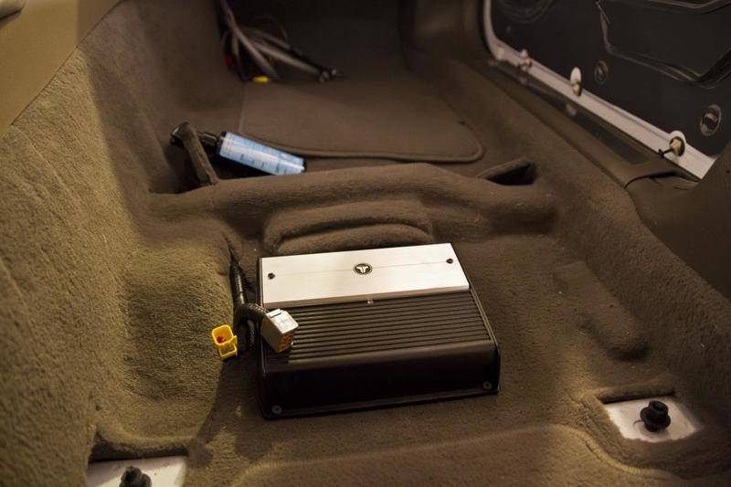

Then I ended up ordering a matching JL Amp for the Sub..

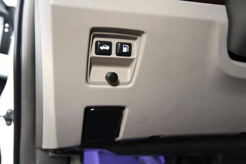

And found a nice location to mount the Gain Knob..

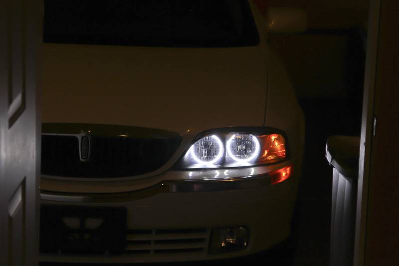

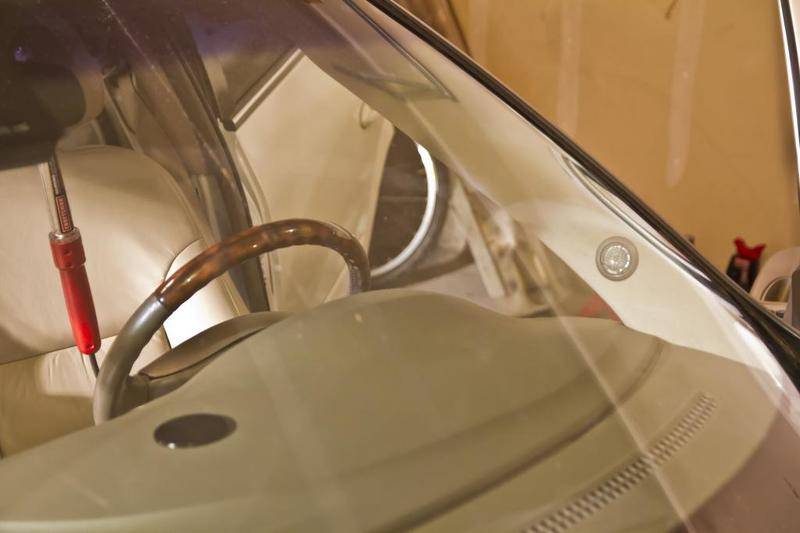

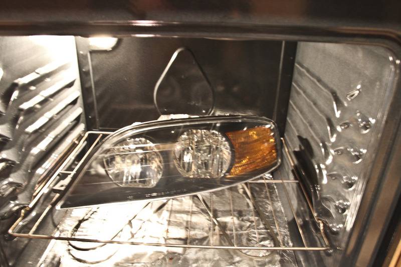

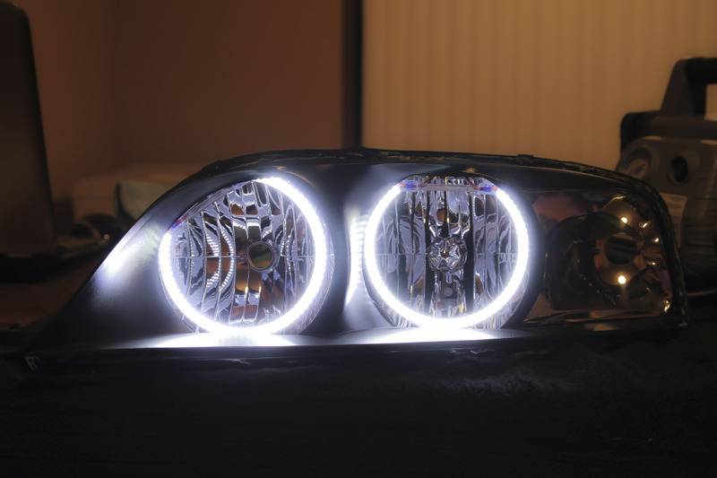

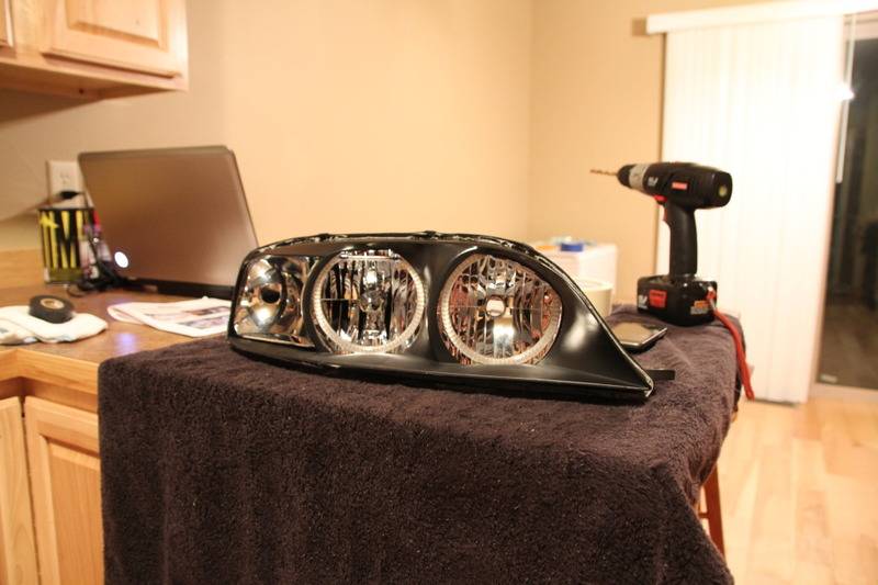

Then I ordered up some UMnitza Angel Eyes and DDM HID's
Time to put the headlights in the Oven.. eeeeek
I also removed the amber reflectors and installed amber bulbs instead..

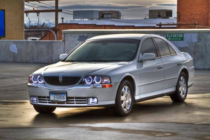

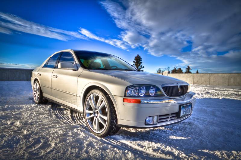

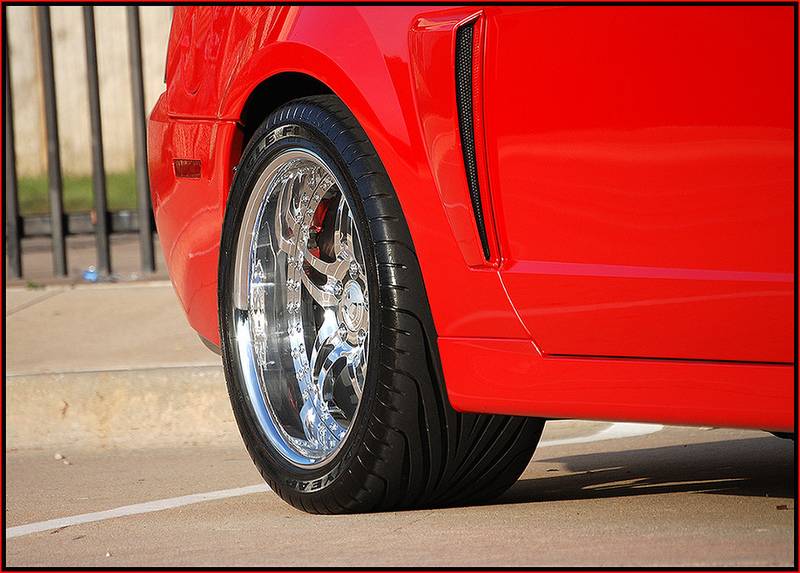

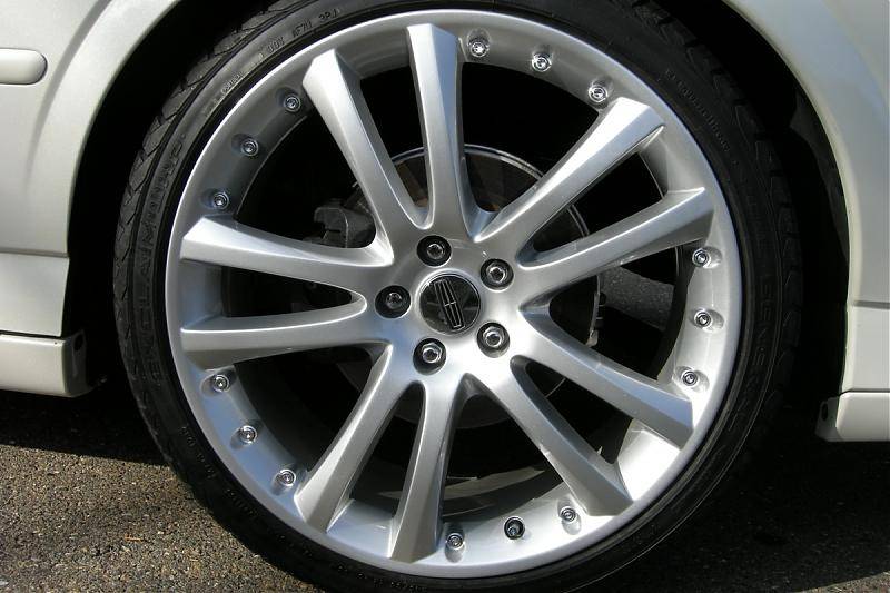

Then I went on a long quest for wheels.. I had my heart set on Vossen CV3's.. They are amazing!! But the LS has a high offset, because, it's retarded.. And VOssen's won't work.
So.. I ended up Settling for Jaguar WHeels.. My choices were limited.. I hated the wheels in pics, and pics still don't do them justice, but they do look damn good on the car in person..
PHOTOSHOPPED VOSSEN'S
My new Wheels
Front wide II by MattWhidden, on Flickr
Front wide by MattWhidden, on Flickr
Snowy Sentas by MattWhidden, on Flickr
closer pearl by MattWhidden, on Flickr
Fender Flush by MattWhidden, on Flickr

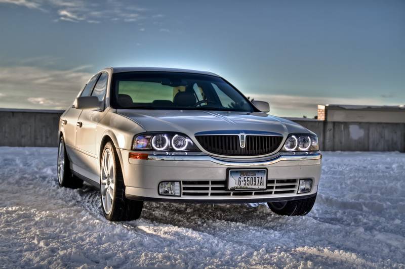

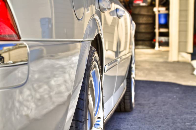

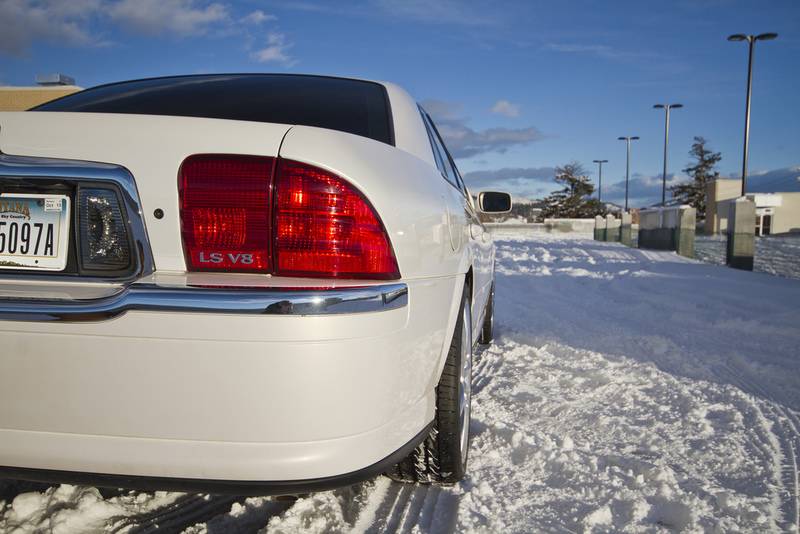

After I got the wheels on, I decided I could lower it. So the next day I ordered Eibachs.
It seems like Most LS's that are lowered are lower in the rear.. The front fender has a higher wheel opening cut, so it's hard not to make it look like the rear is lower..
So to start out, I only installed the front springs, and i think I will leave it this way, at least until, I can have some spacers made to keept the back higher with the eibachs..
Here is the only pic I have lowered so far..
Settled Front's only by MattWhidden, on Flickr
straight on by MattWhidden, on Flickr

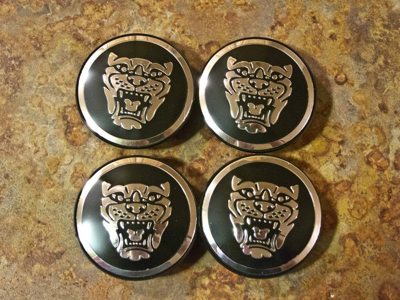

And Finally, the last thing I did was order some genuine Jag Centercaps.. ( My wheels didn't come with ones I liked)
caps by MattWhidden, on Flickr

What Focal components are you running and what's your impressions? I'm looking at the Tni for tweeters- hear pretty good things and the cost is well below the tn53 and tnk
I'm still looking figuring out a mid but damn focal can be expensive

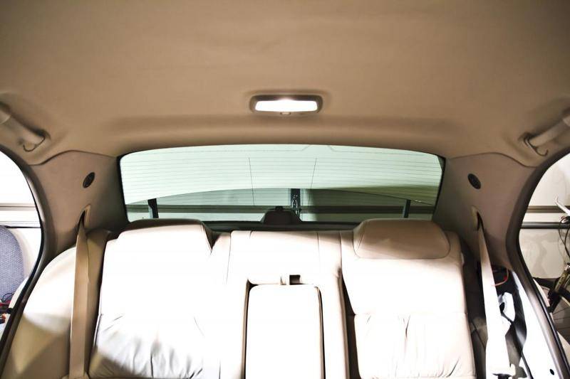

I've always been a big audio nut, especially on the SQ side. This is my first time trying out Focal. A good friend of mine at the local Car Audio place sells them like hotcakes, so I thought I'd give them a try. I'm only running the entry level ones, and I'm most impressed by the midbass. They receive 75watts RMS, and I can feel the bass hitting next to my legs.. They will stay clean as loud as your ears can handle it, and the tweeters are very bright. As you can see, I opted to put them in the pillars for a better soundstage, and I usually just like my tweets up high anyway.. With the tweets in the pillars, I'm running the crossovers at -3db, just to tone them down a little. Everything else is adjusted in my Kenwood.
I had installed a huge Memphis Audio system in my roommates Silverado SS a few years ago, and after hearing my Focals, he ordered two sets for his truck as well.. Best $140/pr we've ever spent..

So far all I've heard is great things from focal. Even though the Ls' factory system is equal, if not better, than most equivalents at the time, I found the factory system lacking in the high range. So while I am planning to upgrade the bass and mid a little, I am really wanting to open the high ends for clarity without ridiculous screeching; hence looking into focals

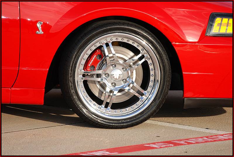

New True Forged Wheels to start with. 19x9, 19x11
I'm also looking to switch to IRS from an 03/04 Cobra.
My blower is pretty much maxed out at this point, so I'm thinking about going with a bigger blower and some meth.
Projector headlights
Paint the other rear bumper I have that says "cobra" instead of mustang.
nice. i'd like to see that. everyone i read about is going the other way. which is dumb, cuz a SRA is stupid. lol.
It can be made to handle very well, but all those guys drag race.. My car is set up for Corner Carving in every way, and with a bushing kit and IRS brace, you can't beat it.. I already have the side exhaust, which was bought because I was going to run a watts link, but haven't quite gotten that far. I do have a panhard bar setup, which I'll sell off. The IRS is around $1000 plus shipping.
