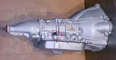

I recently bought a low-mileage 1998 transmission for my 1997 Lincoln Mark 8. Unfortunately the transmission came without harness.
Sorry if this already has been asked, but can I use the harness from my 1997 to install the 1998 tranny? I heard that there's a way to re-wire (swap internals from the 1997 into the 1998) and to re-pin. Most people say that re-pin can cause problems to the ECM and solenoids.
I would prefer to re-wire: does that mean I can use the 1997 harness?

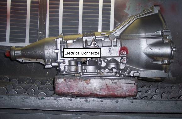

Another thing (firts thought it might not that big problem): one of the connectors on the 1998 tranny is broken (I think due transport from Virginia to Germany), it's the "electrical connector" as I investigate. I think it can't just swap this connector from my 1997 tranny into my 1998 tranny? :(

I don't know but I prefer repinning instead of rewiring. I heard that repinning can cause problems, but only if you don't do it right. In my opinion it's easier to repin a connector instead of grabbing all the electrical internal from a transmission - or do I have an error in reasoning?
What I found: I can use my 1997 harness and repin the main-connector. To verify that everything is correct I look at both the connector pins and wiring color.
Also I found that I need to change the MLPS and use the 1997 TCC solenoid. Wonder why they don't write anything regarding the TCC problematic in the re-pin instruction.
Still need to figure out how to connect the old TCC to the 1998 style internal connectors. Hmphh...

I have a question :-)
The main connector from the 1998 transmission is broken. The part number is F8AZ-7G276-AA, unfortunately this part is completely out of stock. I ordered it at some ford OEM shops but they all canceled the order because there's no ETA for it. Now if found F8AP-7G276-AB which looks exactly the same. Is there a way to determine if that connector is compatible or not?
Thanks!
