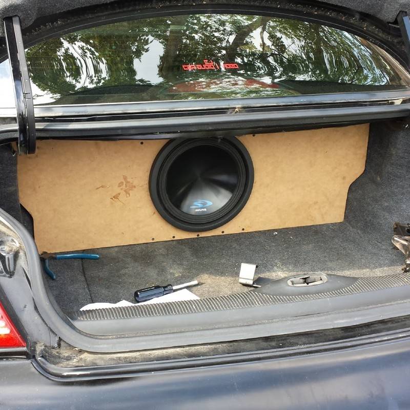

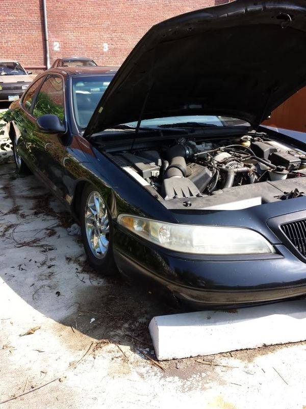

I went to dc and bought this black on black lsc for 1000 bucks I plan on making it a promo car for my car audio shop
It's going to be sweet! Do you still have the template for the box in the trunk? I was wondering if you could send it to me? I want to do the same but put the sub behind the panel.

Seems like she's in very good shape for just 1000 bucks!

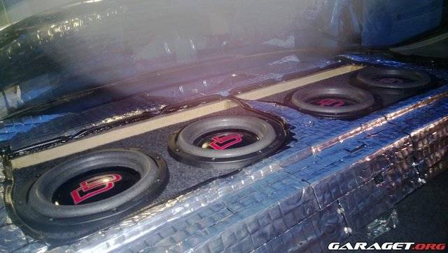

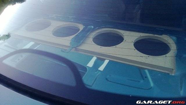

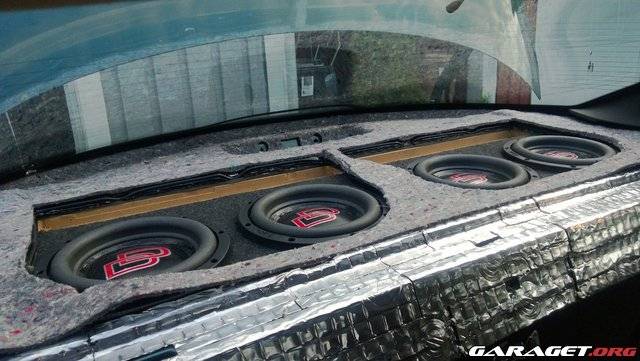

Psst, the rear deck is perfect for four 8" subs if you want to go one step further ;)

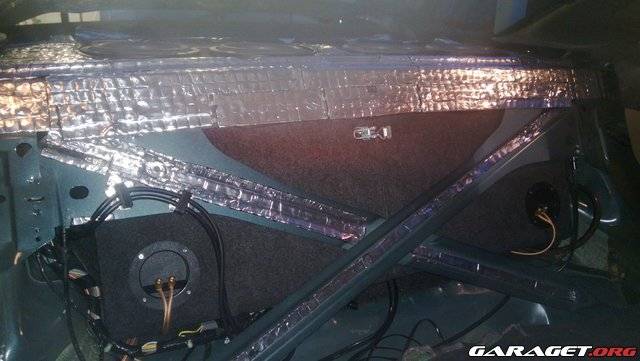

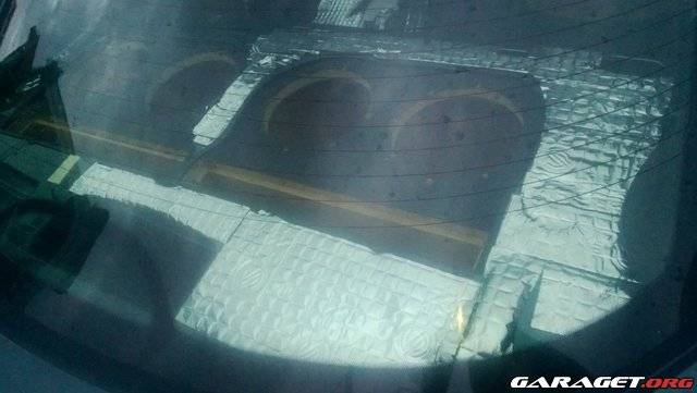

What does it look like under the rear deck lid? Are those subs covered at all?
Under the rear deck there's boxes. Two of them. Two 1508's in each box and both boxes are tuned to 35hz.
Without the slide in ports attached
There will be a cover. I'm going to try my best to get the original cover over them. I just haven't started doing that since I don't have time for it now when I'm working in China.

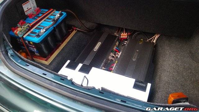

But I'm going to but cover over the batteries and amps so it's all hidden. Atleast a bit.

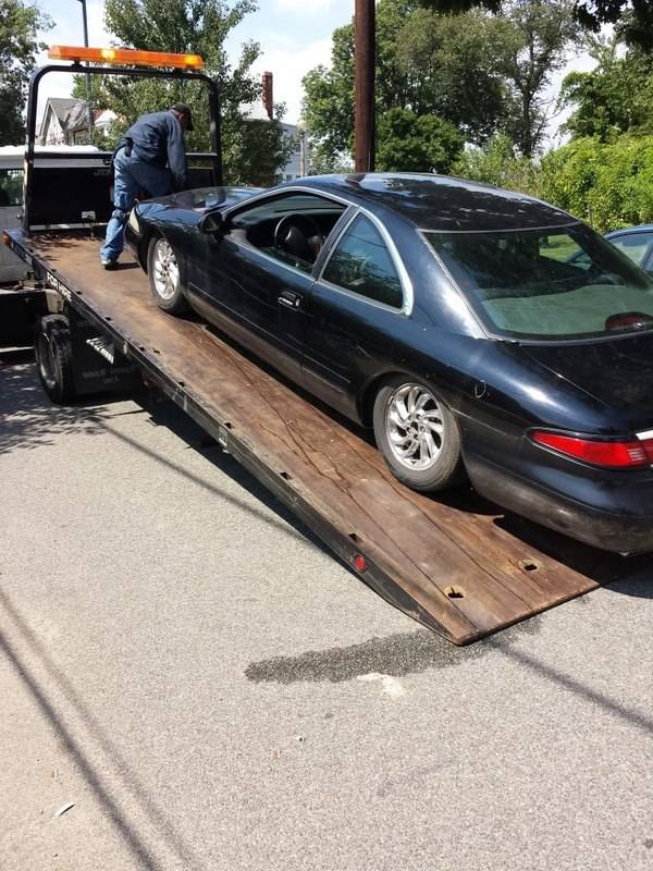

I tried getting this one. Surprised you got the car. His communication was almost non existent. Even offered to pay him his asking price. Nice mark!

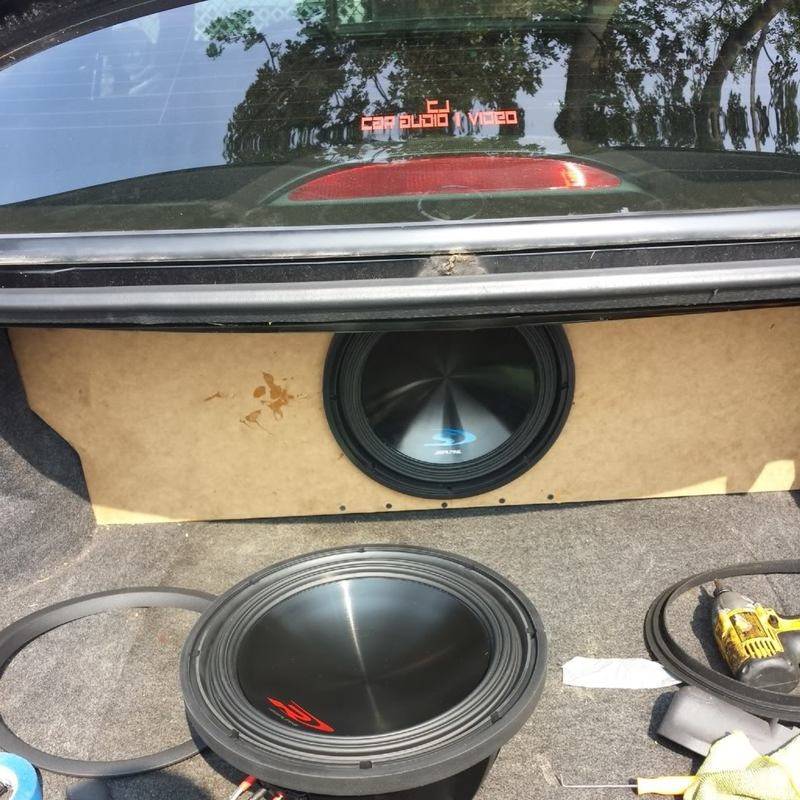

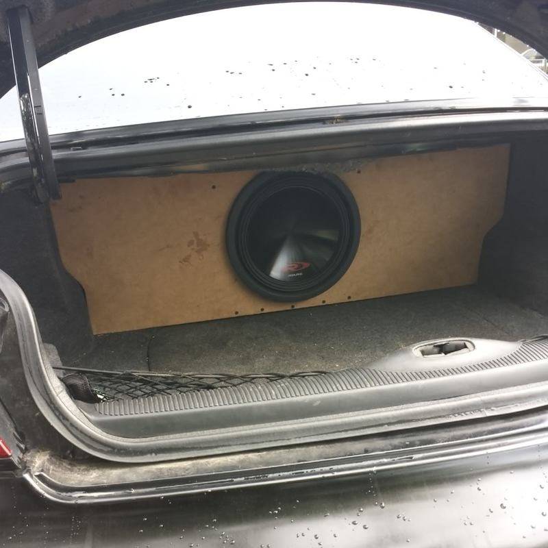

interested in more info on O.P's setup. is that a 12 or 15? is that box sealed or ported? im guessing your going more for S.Q. then getting loud. sorry im really into mark viii bass builds. i've got a 94 w/ a single FI SP4 15 in a 4ft^3 ported box tuned a 33hz on a sundown saz1500. 1/0 big 3, one run of 1/0, 1000cca batt and stock alt. hit 140db sealed on the dash before proper tuning. and it got louder once the sub broke in.

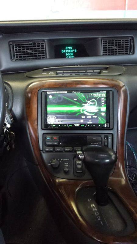

Its a sealed box I built it to alpine specs. It sounds good as hell u can hear it a block away. I took the alpine type s out and now have a type r in there now. Im putting alpine type r components on the inside, basically the whole car is gonna be alpine except for the jbl ms8 im putting in too
Wow really his mom told me a couple people came to see it. To be honest its a decent mark half the stuff that was wrong with it was all easy fixes took me bout 3 hours. It was my last resort some other ones I went to see didnt work out so I said f it
