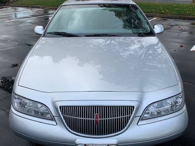

I picked up a gorgeous 98 LSC with not much more than 60k miles late last year, and its been my daily driver since and I love it. When I got the car, I noticed the passenger side fixture had some water spots at the bottom, but the drivers side did not.
We have had some pretty heavy rain, hail, and flooding today in parts of Los Angeles. When I got back home, I saw the inside of the passenger side headlight fixture all fogged up since moisture got in there. I wish I had taken the damn fixture off the car when I got it and sealed it with silicone when I saw those water marks at the bottom of the fixture.
I am going to take the fixture off the car when the weather improves. Has anyone taken these fixtures apart before? The car has original HID lights stock that work fantastic, and the fixtures are actually crystal clear as well as you can see in the pics taken as I bought the car.

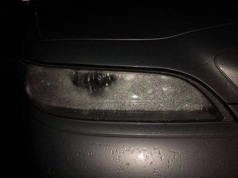

FUCK FUCK FUCK!!

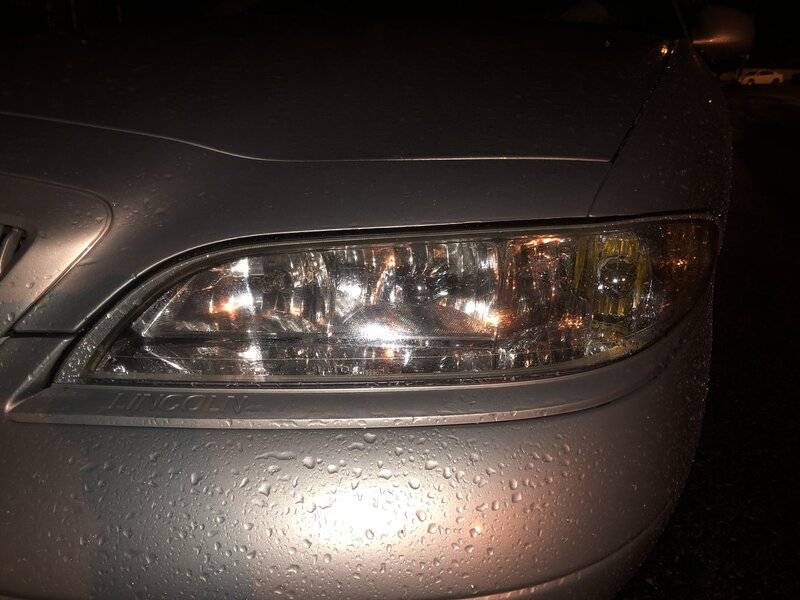

I went outside to check the headlight and the HID is no longer working in the fixture that is full of moisture. They were working perfectly until the storm came and I can kick myself in the ass for not taking the lights out and sealing them when I had a suspicion that it leaked a bit. Although this time it seems to be leaking quite a bit. There’s no water running around in the fixture or anything - it’s just a lot of condensation moisture buildup on the inside of the lens.
You can see the pic of the drivers and then the dramatic difference of the passenger side now. As soon as the rain is over with I’m going to take the fixture off the car to see if I can dry it out and hopefully salvage the headlight that’s in there. I went down with a plastic bag and have it situated over the headlight and close the hood on the plastic so it’ll stay put for now.
I really need to dry out the fixture completely so I may use a hairdryer and compressed air when I bring it upstairs into my place to work on. If I end up needing to get a retrofit kit to change the HID lights to the newer ones there is a kit on eBay for $299. But if I cannot get the headlight taken apart and cleaned properly inside then I may need to just get a new light unless anyone can suggest anything I can try? I’ve never taken these headlights apart before! I’m hoping when I get the headlight apart and try it out maybe the light will start working fine again. The high beam and the turn signal are working - just the HID that’s out and it’s showing up to check headlights on the maintenance monitor in the dash too.

Wow, your car looks mint! I had the same exact problem as you about a year ago. I took the housing out and razored away the OEM caulking as best as I could around the lens joint to the base, rough the seem area up alittle with sand paper and used a top quality Auto seem sealer over the entire joint. Fixed. I blew it out with light air pressure and left it out in the sun upside down for a day first and once bone dry, did the work.
