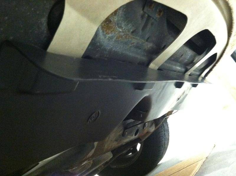

Step 3: Take off the lower radiator air deflector, has 3 screws up front, and a bunch of push pins in the back of the piece:

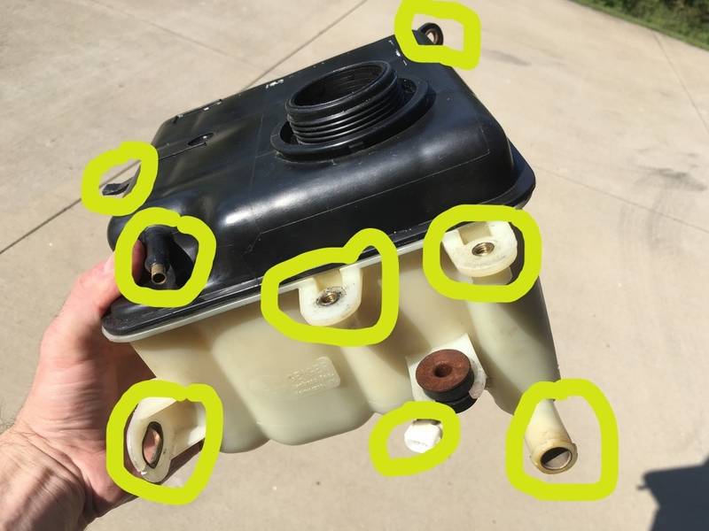

Step 5: This is optional I took out my recovery tank to clean it to get all the sediment out. Here is what you need to take it out: (I circled the bolts/fasteners that need to come off for your viewing so its easier)
1. Top recovery tank bolt 10 mm nut.
2. Top tank side bolt into fender well is 8 mm nut.
3. Power Steering Tank bolts both 8 mm , get a bungee cord to tie it out of the way so you can have easier access.
4. Washer bottle neck 2 bolts in center of brace both 8 mm.
5. 2 Fender brace (black bar up front) bolts both 10 mm or so.
6. Unplug the low coolant sensor. (Make sure you cover the connectors with electrical tape so they wont corrode when you wash the tank)

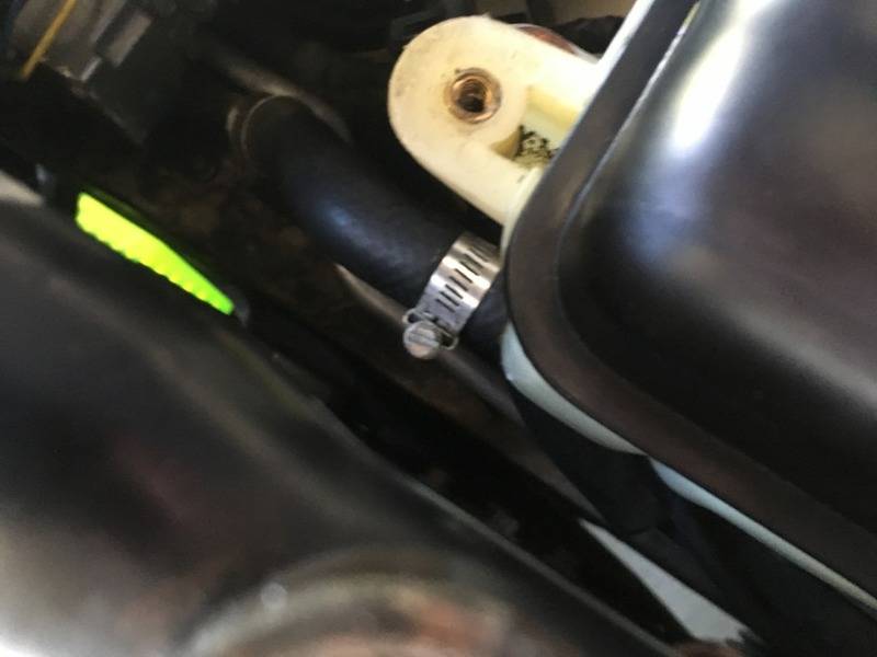

7. Optional: I replaced the snap hose clamp with a small radiator clamp with flat head screwdriver nut.
*8. Slide small hose clamp off of the tiny return line on top of the recovery tank, then pull hose off.
All Clean:
View with tank removed:
Replaced old snap clamp with screw type:
All put back together again:

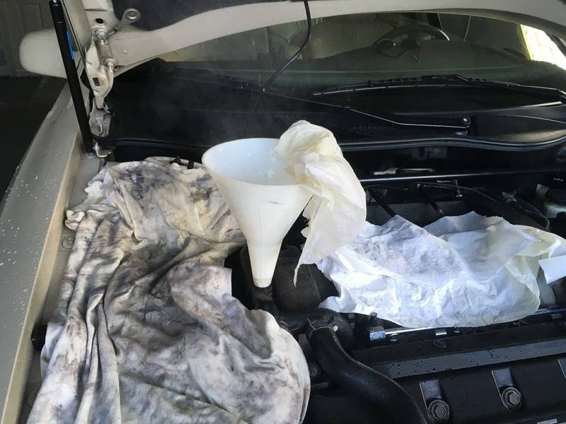

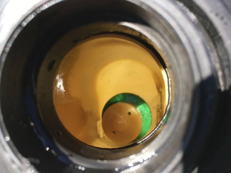

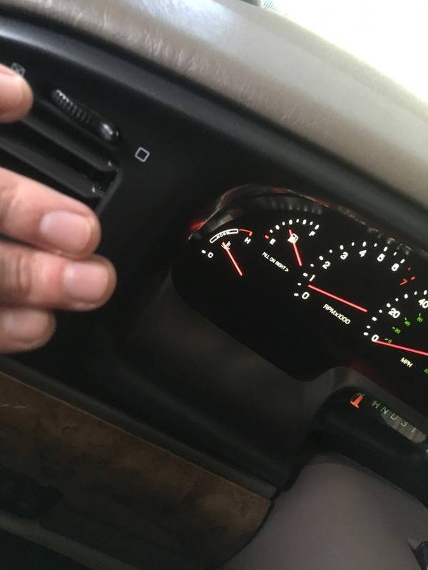

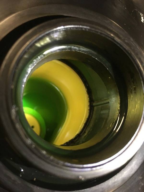

For starters close the reservoir recovery tank cap, leave the small coolant bypass tube vent open, put funnel on top of it. Start the car, turn your heat and blower fan to MAX. Coolant will spew everywhere and go flying, mine did, when the temp goes up, until it levels out when no bubbles can be observed turn engine off and close the bypass tube:
Venting and steam coming out, heat was medium to hot out the vents inside if car:
Inside temp where it should be:
Bubbles can't be seen so the air is out of the system:
Once no bubbles can be observed turn engine off and close the bypass tube vent.

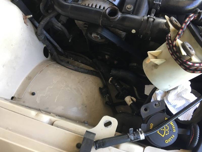

Where is the bypass tube you keep talking about? Is it the little tube in front of the radiator? Should you always fill through it? What happens if you only fill through the reservoir tank?
Svets96
Jul 18, 2005
750
124
North East Ohio
The bypass tube is the black tube with a screw cap that is located above the alternator. You have to fill the car with coolant through this tube above alternator, it will make sure the block and radiator are filled with coolant. If you fill just the reservoir with coolant the car will run hot. It won't get into the coolant passages of the motor. This is a dry return cooling system on these cars. A 1/4 drive ratchet will fit the screw cap on the bypass tube, make sure you heat it up with a butane torch because these caps are known to seize. It has a rubber o ring on it, make sure you replace it with a new one. You can get a CNC machined cap with a nut on it like I have. Contact 98Mark8lsc to get one.
