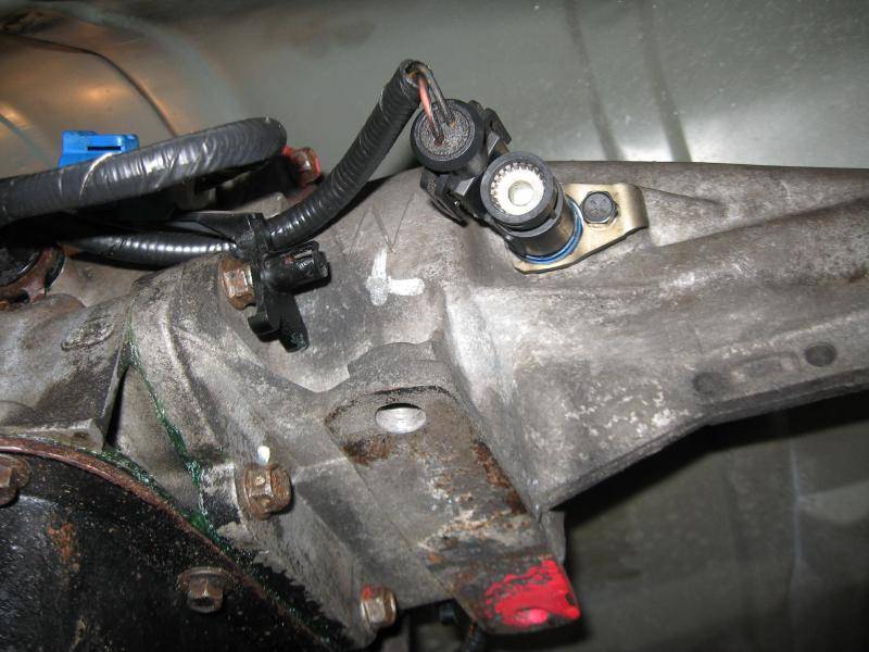

I would also pull out the VSS (see photo) and check the VSS sensor gear for wear and condition. ? The gears are made of some kind of hard plastic and eventually they wear out or brake a teeth or more that may cause it to jump or not engage properly with the rotating output shaft until it stops turning for lack of contact due to wear or broken teeths. . . Gears are colored coded per application. Mine have 19 teeth that contacts and runs on the 8 steel teeth grooves of the output shaft and is beige in color. You can obtain the VSS gear separate as spare part from a dealer..to match your application: model car, year, transmission, rear axle ratio, tires, etc..
