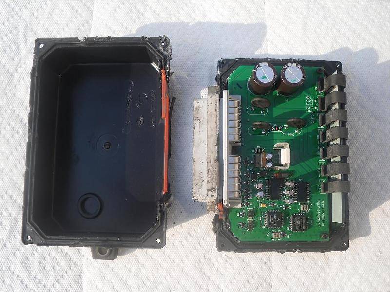

What did you find? or did you just sledge it? :lol:
Nah. Just took it apart, looked at it, and then shot it a few times...:D
But this is what it looked like before it was obliterated.

Interesting. Shame you blew it to bits, I'd like to see if they are repairable..
Bob, do you think you could repair one? I got 3 good ones and a bad one. I saved it because I too was going to take it apart and see if I could fix it. We fix early 90's Honda transmission control module circuit boards at work quite often. It just seems like I never take time to do it. PM me.

And FYI, we took the old one apart too, and it looks just like the one in that picture..ha ha..So car runs great..but because is the year it is, we are going to sell it..bought a 1997 Linc continental..paid 800 for it, and its clean. low mileage, been in an estate for 6 yrs..so will have to probably replace a bunch of stuff, but at least is not one year only.
