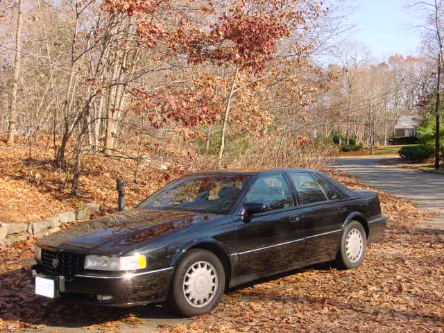

My 94 Seville STS had 30,000 miles last summer and I got it for $6k.
