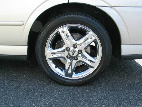

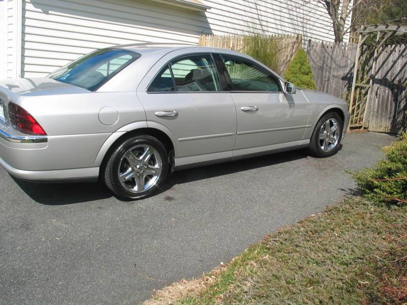

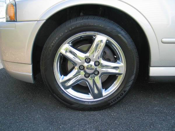

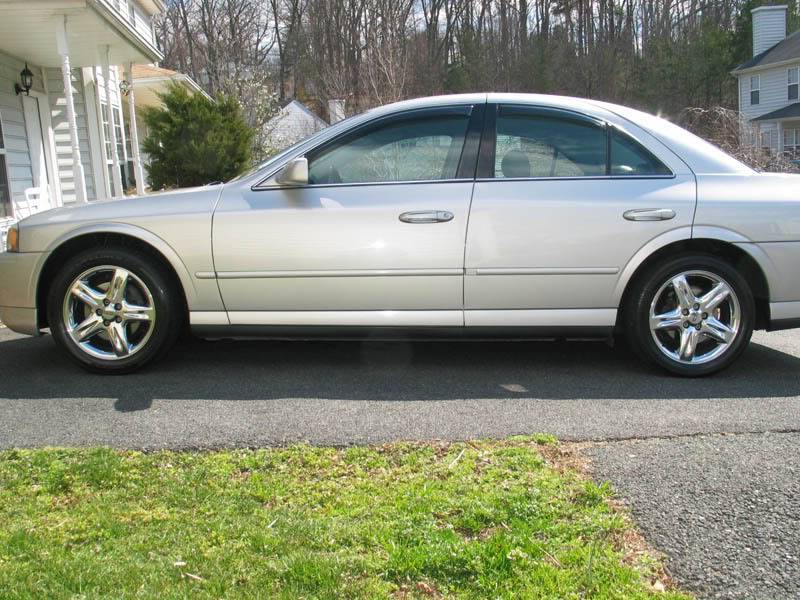

Ok, pics of the size difference between 235/50 and 245/45 tires.
the 245/45 first
then the 235/50
wide view comparison
Hardly an difference at all in the size. The 245 tire is 1cm wider than the 235, and about 1.5cm shorter in overall height.

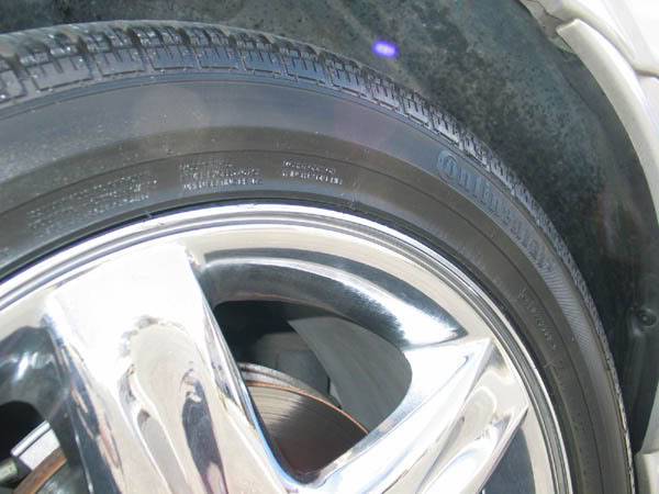

One difference that does stand out in the pics, is the Rim Guard on the 245 tires. Not all tires have this. And the ones that don't will appear to baloon out some, like the 235s do in these pics.

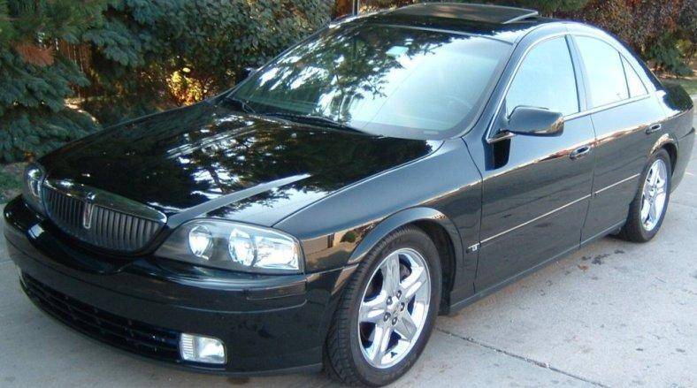

Attached pic for reference off my old 02
