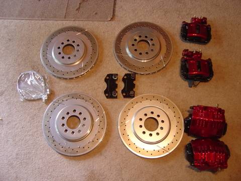

Well I am slowly dragging my mountain of parts out piece by piece to put on the mark...
The first installment was the 20" BOSS rims which I bought to specifically fit the 13" cobra brakes I was installing...
Well I got the kit from Disc Brakes are Us... GREAT to deal with and the parts look spectacular...
The installation was a SNAP... got the fronts on in under an HOUR! :)

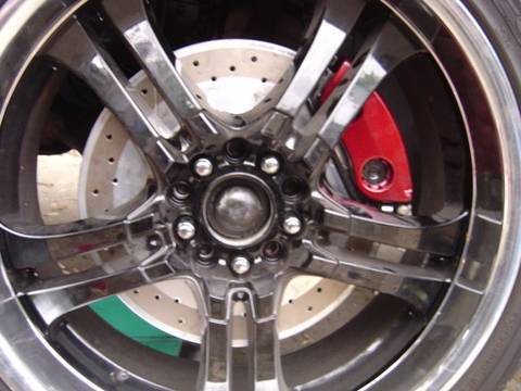

Well thats where the fun stops... I bolt up the wheel and it RUBS!!!! Expletive deleted...
Just a smidgen...
So I go to put the stock stuff back on and the passenger caliper is shot... leaking like a sieve
Gotta go source a 5mm spacer now for this damn thing... GRRRR

I had issues to with the 20" Drivs I wanted to put on my car rubbing the caliper bracket. I've never liked the idea of spacers so went with a different set of rims.
Where is yours rubbing at? I clearanced the brackets on mine, bit it still wasn't quite enough but they were plently strong still. The brackets don't move so it should be fine to take a little bit off if you need to...

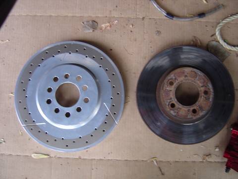

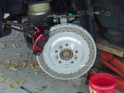

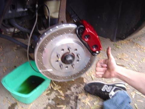

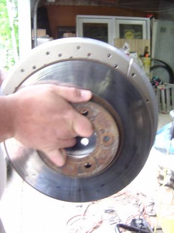

Okay... got it all together with a 5 mm spacer (smallest I could find local)
Everything fits but I why o why do they powdercoat the rotors????
Dumbest thing ever
Here is a few pics!
BTW the thing stops likes nobody's business now!
