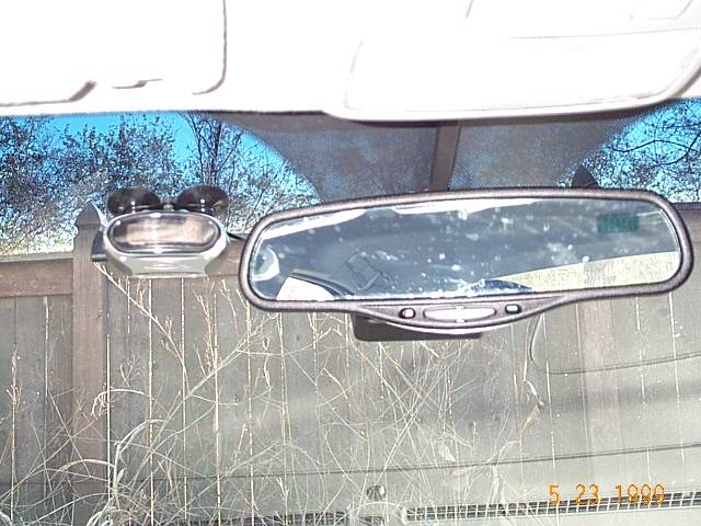

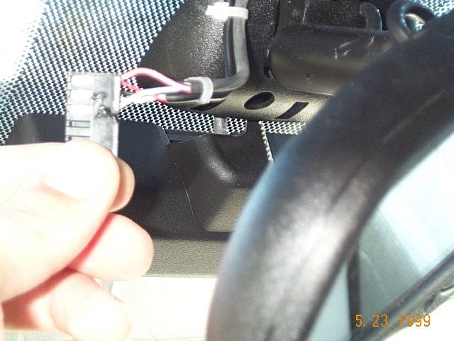

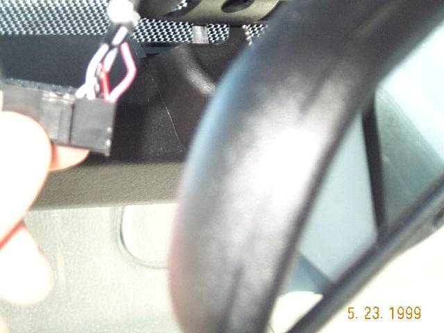

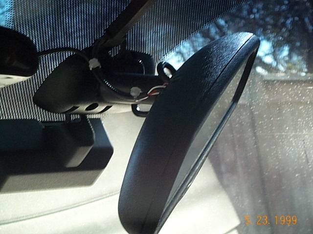

I wired my radar detector into the harness at my mirror. Nothing to it. I even pulled the female pin slot out of the mirror's plug, soldered to that, put it back into the plug, plugged the plug back into the mirror and I'm good to go. It's a 12v switched hot. I don't recall which wire. I'll try to get a pic of it tommorow.
It is super easy, switched, and has been running like that for like 3 months with no problem.
Installed:
Here is a full article on it. I hope it helps anyone attempting to do this.
