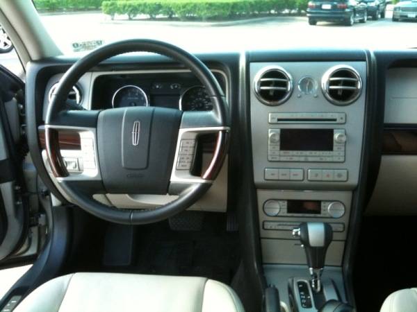

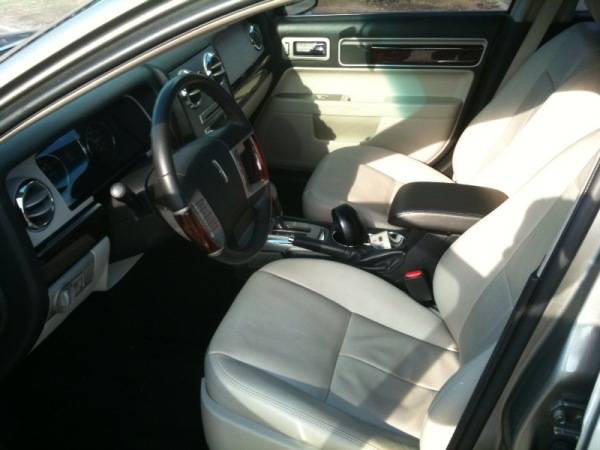

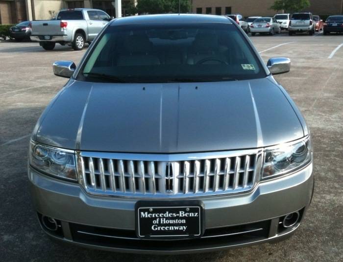

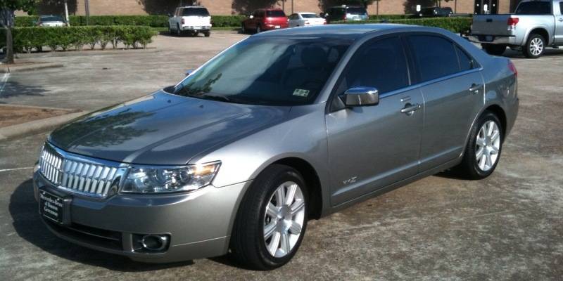

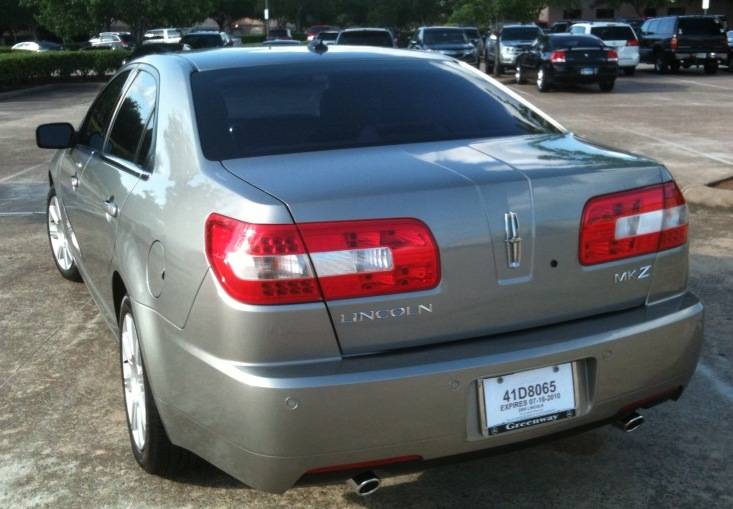

Here are a few I snapped today with my iphone while I was waiting.
The outside styling is good for me, I like the angular lines. I think the inside is probably a love it or hate it for people. I happen to like the look and the way its laid out, but it may be too much dash for some.
And the cooled seats are just ridiculous with the AC on high, gonna be nice in the summer though down here in Houston.
