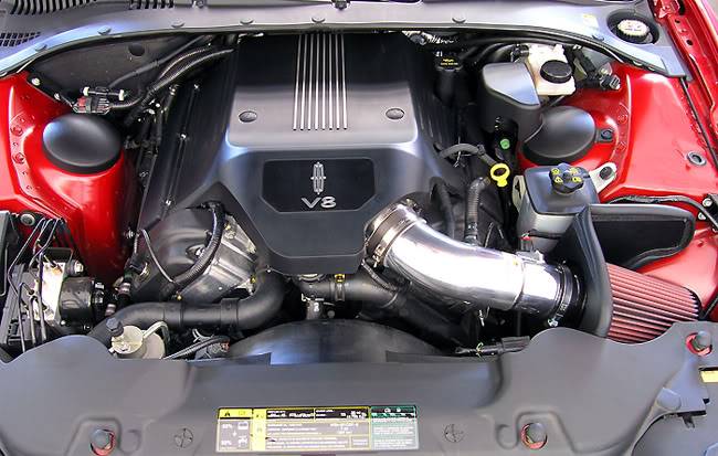

My experience is that the throttle response on the '06 is much better than the '03 (I've owned both) due to CPU programming upgrades and this intake will not void your warranty unless you installed it incorrectly and don't clean the filter properly or regularly. The only part you could damage is the MAF sensor, so handle it with care when making the swap and when cleaning your filter. Most of the time, damage to the MAF is caused by using too much oil on the filter during the cleaning process. A very small amount of filter oil goes a long way. Nothing will kill a MAF faster than having it covered with oil.
The only other problem you may run into down the road is Smog Certification. This intake is not CARB certified. So, depending on what state you like in, keep your stock intake in a box somewhere and reinstall it on the car when it's time for you to go in for a smog check. That's what we have to do here in California.
Other than that, it's a great CAI system. I have it on my 2006 and we love it.

I love my Typhoon also...
Look what it replaced!!!

Thanks guys for the responses. I will post some pictures once I have time to take them. My car looks like T_Man's without the exhaust. But it does sound great. The next thing will either be the SCT Flasher or the exhaust. From what I've read, just buying some Magnaflow mufflers and getting some sweet tips will be the best thing to do since there is not exhaust for the '06. Am I correct?
