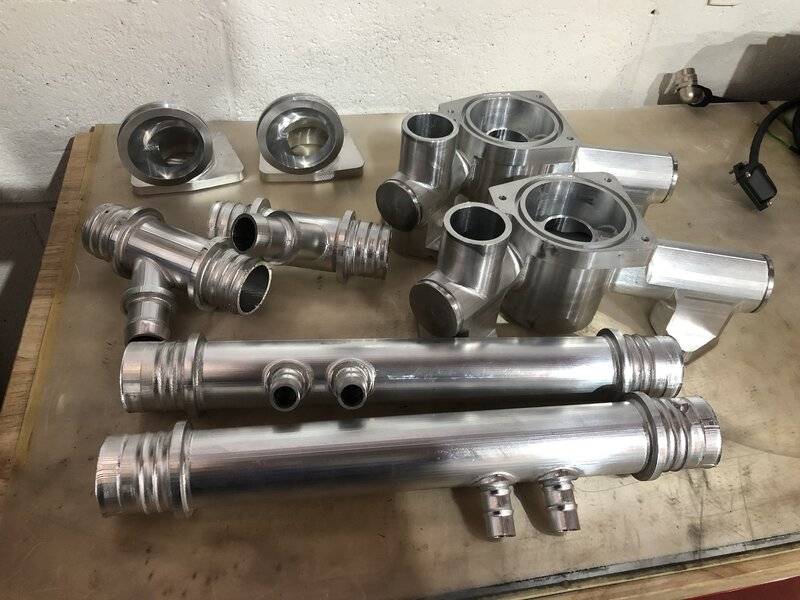

When you had enough, here's one solution
All custom pipe and degas tank for one set around 1700-1800 with 6061 machined parts. So only sys plastic is the thermostat housing and dccv. I could have those made in

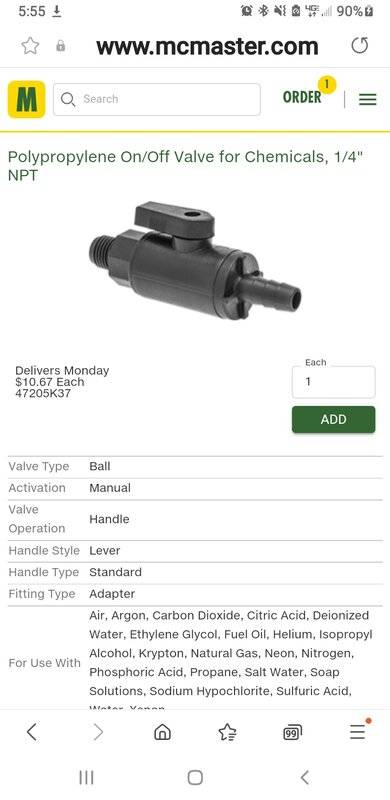

AL also if needed. If you want to replace the radiator also because the the plastic tanks splitting open, Ron Davis Racing Radiator has an my example radiator sent for a two row custom unit with a extra cooling tube on the driver tank added for 1100 ( beautiful job ). I had that unit anodized black at Ballard Aluminum for cooling enhancement for150. The valve is for those hate scalding hot fluid when bleesing the air, i found this plastic valve. Also the tube line for the throttle body to the bottom of the engine v, will be made of al AL for that mysterious leak getting made in H-town. Should have a photo soon when i pick two up.
