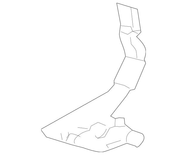

Does anyone happen to have a picture of what 4W4Z-19N550-CA actually looks like? I've only been able to find an illustration, which isn't exactly helpful:
