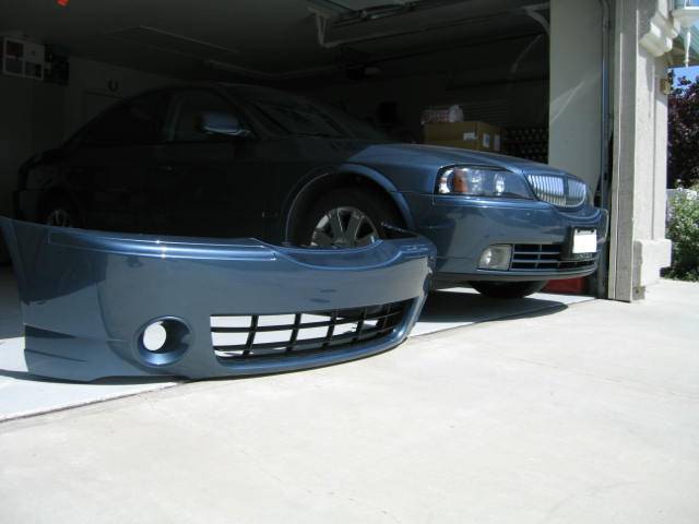

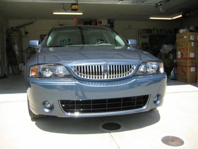

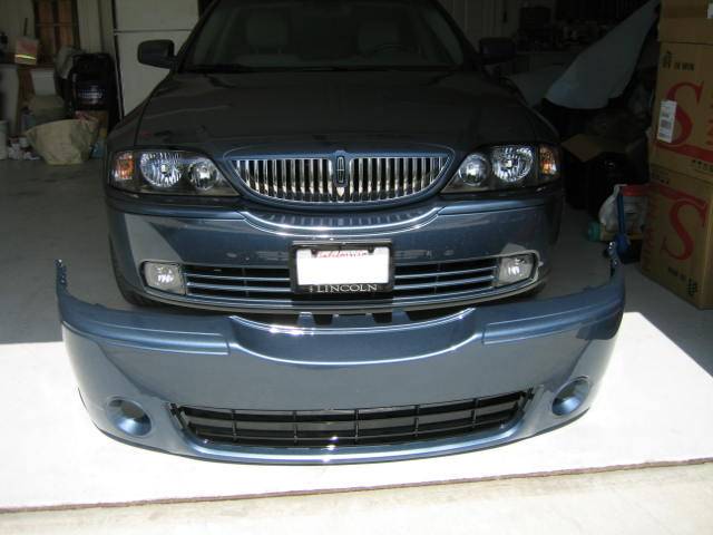

Picked up the bumper this morning.
Lower grille looks good painted black.
You be the judge.
yep.. leave it black.. looks pretty sick.. likin the color
Looks nice, you should definately put some chrome strips down there.

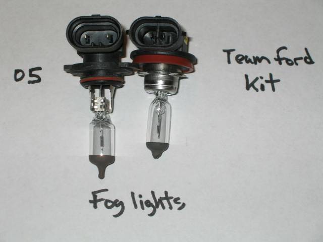

Kit is installed, but its to dark to take good pictures.
I ran into small problem.
Fog light connectors are different than my 05.
Any Ideas.

That is correct. The 04 and up LSE's take the H8 or better yet H11 bulbs. The other LS's take the 9145/H10 bulb. Get the H11's instead of the H8's. The H8's have a very low wattage to them.
I'm confused, so how do I plug an H8 or H11 when the source connector is different.
you will need to buy the H8/H11 connector. Ken has them.
That looks really good. As for the connectors, you'll need the H11 connectors to use for your fogs. You can purchase the connectors when you get the H11 Xenonmatch Plus bulbs. I don't sell the connectors separately.
So that means I have to cut off the old connectors.
I wonder If Bill at Team Ford knew about about this incompatiblity or I am the first to purchase this kit.
Bill emailed me today about this. I told him that people would have to cut the existing 9145 connectors off and splice the H11 connectors to make it work. The H11 Xenonmatch Plus bulbs are $36 a set and the HD connectors are $19 a set. Plus shipping.
