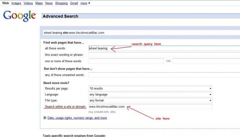

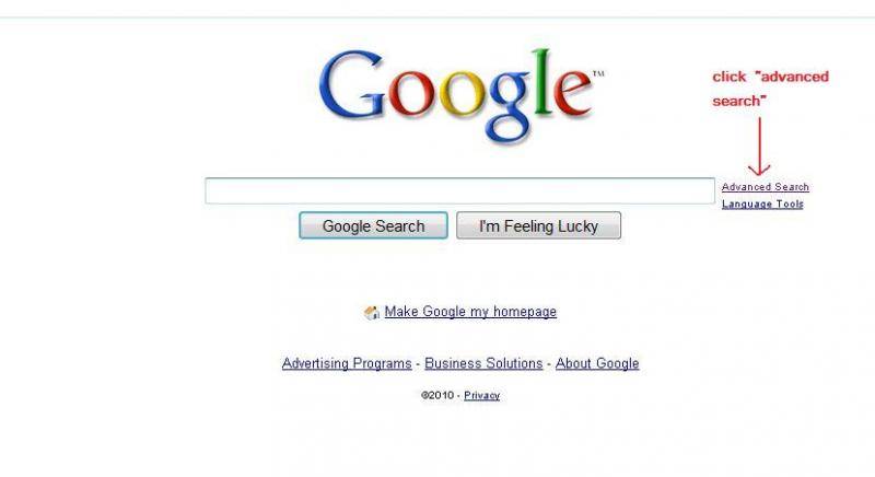

The search feature on lvc sucks. Try doing a search on google. Click advanced search. Then you can type in your search terms, and in a separate box you can type in the URL of the website you want it to search within. Works a lot better.
Check it:
