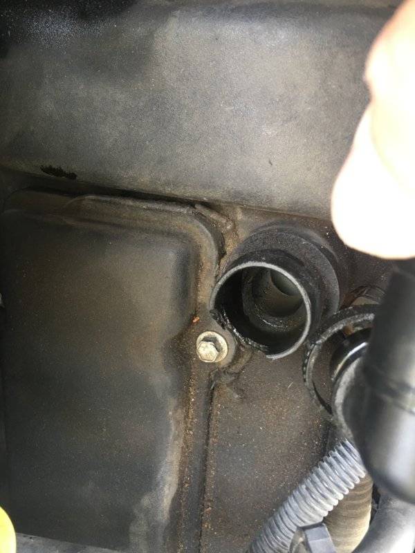

    Here’s a picture of the broken crankcase vent tube attach thingy (can’t find right word...lol).

    Oh, I thought you meant the release clip on the hose. You would have to replace the valve cover to fix that. Still, it probably isn't leaking. You can hold an unlit propane torch to it (hose connected) with the engine running to verify. If idle changes, then it is leaking.

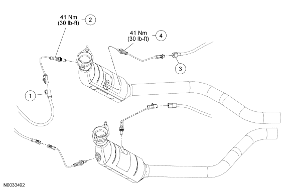

        Do you mean #2 in this diagram? The Heated Oxygen Sensor? My CEL came back on 1500 miles and over 2 weeks after I replaced my fuel filter.
        I am also thinking of replacing all the vacuum hoses. What size are the hoses? Or is there a kit that has them all?
